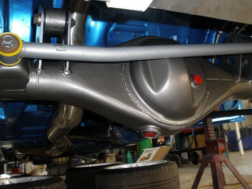

    Here's mine, over diff.... 3" Mandrel - No excuses now guys, my car runs as low as any 86 with functioning suspension can. Admittedly, I have now scalloped the sub frame to allow further clearance, but originally had the exhaust over diff without altering the body in any way.
    Oh, and did I mention its a Hilux diff - A fair bit bigger than the average S or T series.

    Just go under FTW! MEdwin Man your undercarrage looks neat as! top stuff..

    Jeez clean undercarriage Medwin, I'm guessing your's is a turbo hence the 3" pipeing?
