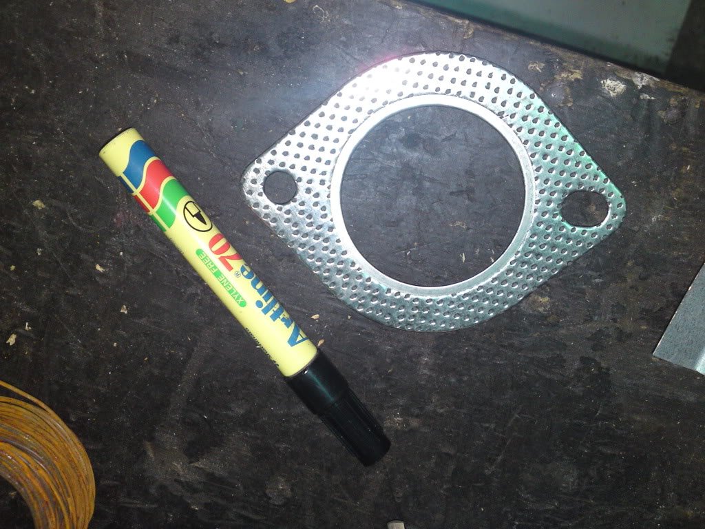

un-bolt your rear most exhaust flange and remove the gasket, take that to an exhaust shop and get 2 new ones for every plate your making (if your gasket is in good condition you will only need 1 new one)
3.

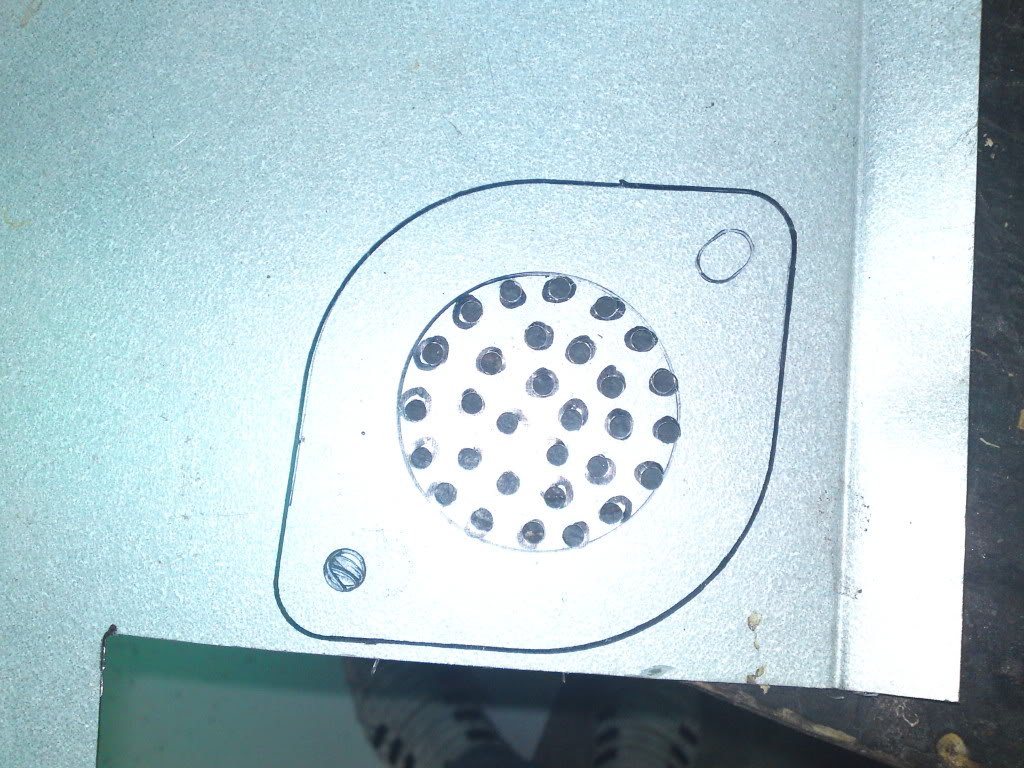

get a sheet of 1-2mm of tin/steel/whatever you can get your hands on and lay the gasket down on it and outline the gasket.

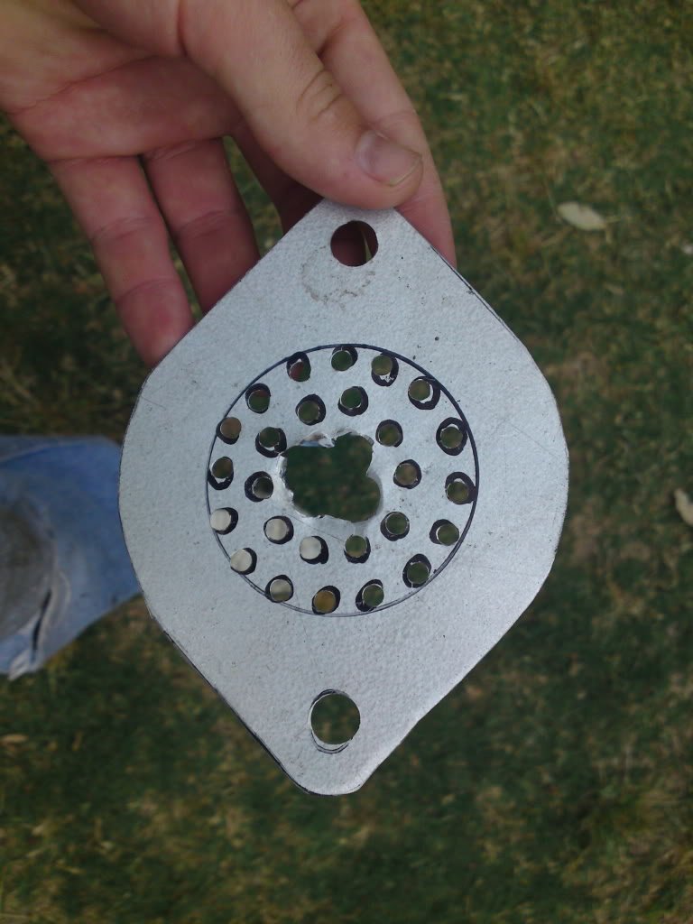

once this is done plot out where you are going to put the holes, i used 12mm one in middle and lots of 6mm holes around it, it dropped 8db.
REMEMBER TO NOT RESTRICT THE FLOW TOO MUCH

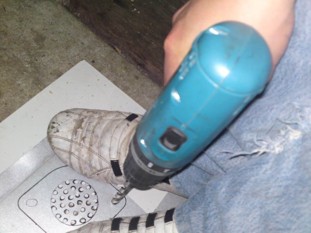

place the sheet down on the piece of wood and get the drill with drill bit and put your feet as close to the holes you are drilling as possible to stop the metal from pulling up.
start drilling the holes!
5.
once all the holes are there and your happy with the pretty pattern you made get out the tin snips and cut out the plate
6.
sandwich the plate you have just made in between the flange gaskets and put it in place and torque down those bolts

yeh this is purely for engineering my car, the sound test came up at 89 dbA which is a hell of alot better than the 121 it started with before the muffler and baffle plate
the you want to make sure the hole size is no smaller than whatever is stock on your engine, so if you have a 2 inch stock exhaust then make sure you have a minimum of 2 inches of holes.
easiest way to do this is drill the holes as close as possible which will leave you with minimum restriction and maximum diffusion of the sound wave
