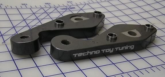

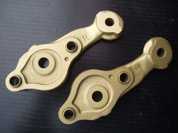

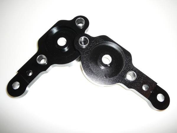

    Ok, i bent a power steering arm last week, and since i have to replace it i thought i might try something new.
    There are a fair few different ones floating around now:
    Techno Toy Tuning (T3):
    Garage Clear V3:Vid
    3Up: Expensive! but nice
    Hibino's (not sure on name sorry, but JESUS he has some lock):

    I already have bucket loads of lock (ps arms, extra lock rack ends and long tie rod ends to support) but i think if i go for a knuckle like the ones above, the inside wheel will hit the castor rod? (i have about 2mm clearance on lock now). I know the solution is less wheel offset/ spacers but its not do-able for me atm (5-0 fail).
