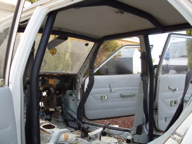

got cage in, not fully bolted in yet tho..

hey mate, car is looking the goods.
where did you get the cage from? very keen to get one for myself.

i just bought it from a guy on here.
jay is making them tho, not sure if they'r done yet
