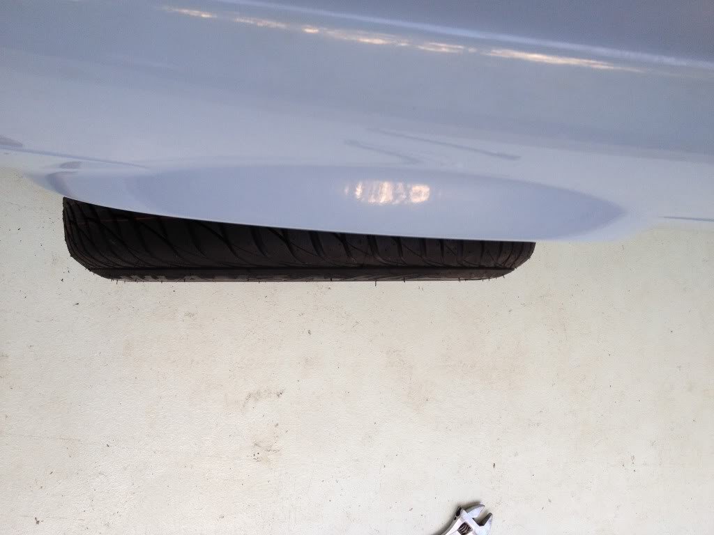

    a 195/50 on a 15*8 0 offset will have about 5mm of poke on the rear with stock guards
    the same size on the front will poke about 7-10mm with adj camber tops maxed out with stock guards
    front corona xt130 struts, ke70 lca,195/50 on a 15*8 zero offset, adj cambertops with max camber, stock guards
    front corona xt130 struts,xt130 lca,195/50 on a 15*8 zero offset, adj cambertops with middle camber, stock guards
    rear, same 195/50 on 15*8 zero offset, stock guards. note: car requires adj panhard, pictured side has 10mm of poke, other side has about 3mm

    Mate, thank you, you're a legend.
    That answered all my questions. Test fitted 15x8 +0 SUperlights today with a 205/55/15. Think I will be going for a 185/55/15 or a 195/55/15 in tyre size though, as the 205 just didn't have quite that much stretch.
