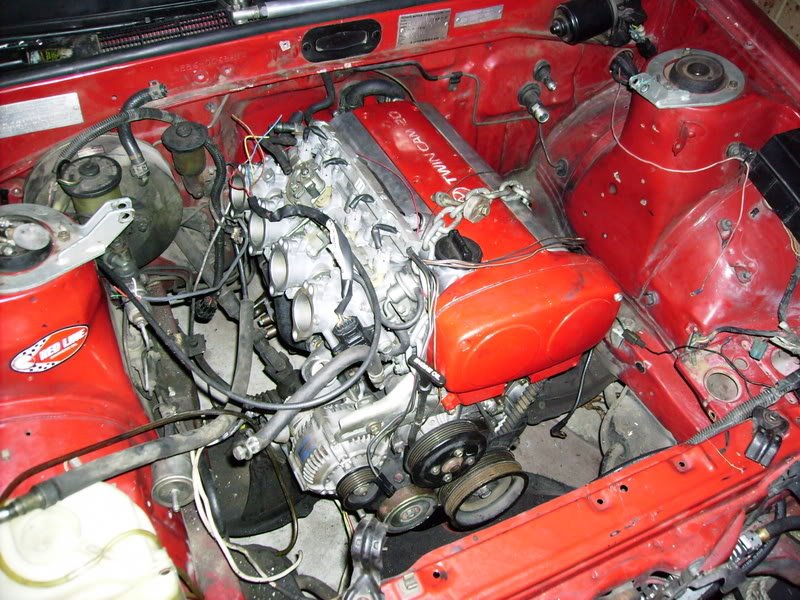

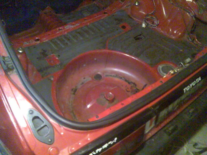

I have recently lost my licence and the hachi is off the road for 6 months, so the transfiormation has started, I'm just doing a few little things at the moment like removing sound deadner, getting the motor ready to come out by pulling of un needed things like the a/c compressor and condenser etc. when I get some more cash in my pocket ill be buying a custom bellhousing for a w series box, and a microtech ecu to run my 20v, but anyway here are some pics of my progress for now, ill keep you all updated
sound deadner out of the boot so far.

my silvertop 20 valve

motor is mounted

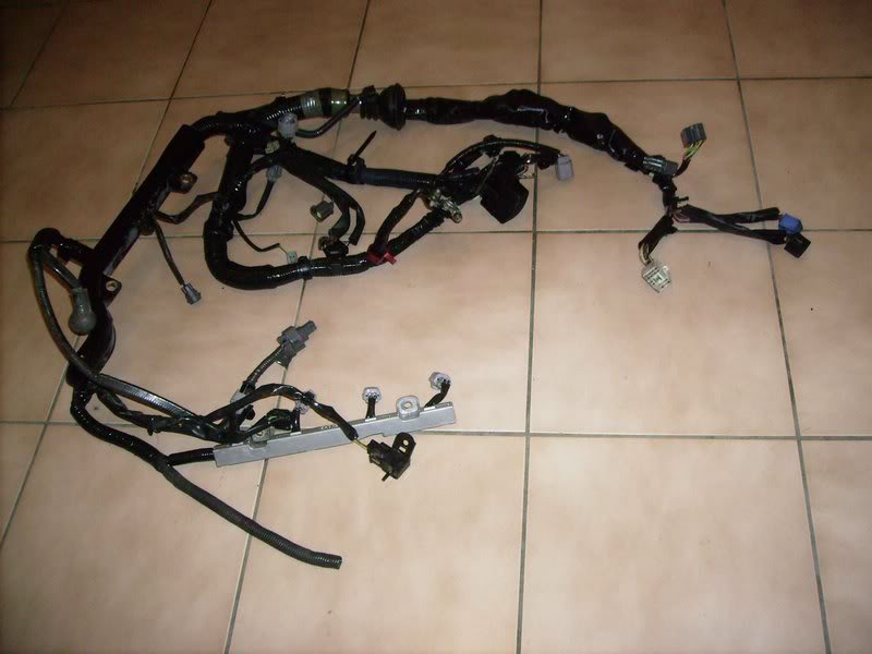

well havent done anything more to the car itself since last updat accept sussing out my method of wiring the microtech and came to the conclusion that to make it a neater wiring job I will need a new loom so I purchased a 99% complete blacktop wiring loom for $150. I also drove to brisbane today to track down the rest of my rwd cooling kit from anthony kellam that waited 3 months for then only got half of it, so I had to drive 3 hours to brisbane to get the rest of the parts I didnt want to wait another 3 months for and also realised I didnt post a pic of my 4ag/w5x bellhousing so here's some pics hope you like

the loom

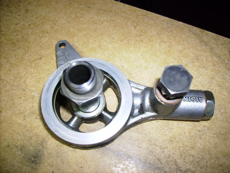

UPDATE!! 8.5.2007
well another update..... havent done a great deal lol I have knocked the sound deadner out of the front half of the car now and have had the cops called twice for doing it(noise complaints lol) glad thats done...also got my new wheels they are longchamp xr4's in 14x6.5 unsure on offset I think 1 pair is +10 and unsure on other but they sit well on the hachi...also got my oil cooler kit almost finished I have everything installed bar the cooler as I don't have it yet... made custom oil return fitting for the sump...forgot to take pic b4 it went back on the car but yeah... will have the wiring started in a few weeks as I have to take my car to clemo55's workshop to do it and I'm not doing that till I have fully paid for my w58 which will be paid for soon hopefully and then ill be able to throw the whole running gear in it and wire it and it should move lol then I just need to get extractors and an exhaust made and a set of trumpets and I should be able to drive it... will do the un neccesary mods while it's on the road as I have a very strong urge to drive it anyway here's a few pics: :2thumbs:

oil cooler sandwich plate:
note the model of oit filter haha crazy coincedence it cam with my 20v

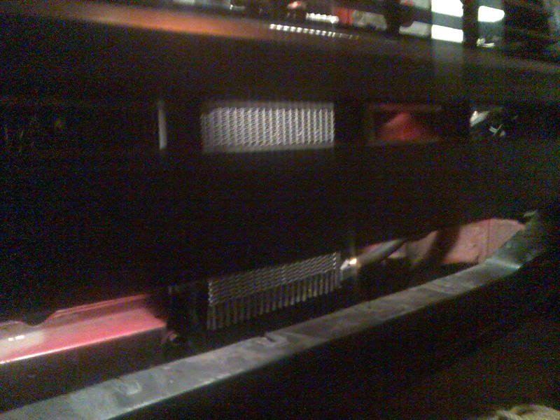

UPDATE!! 29.5.07

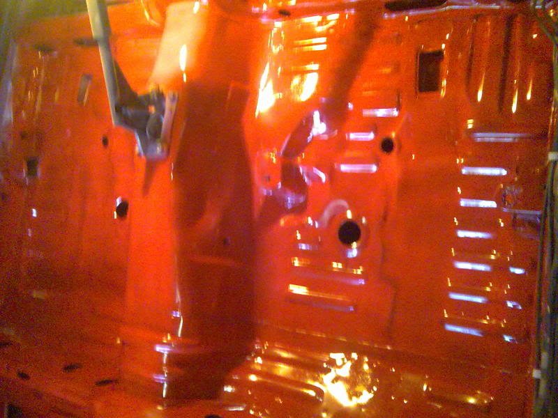

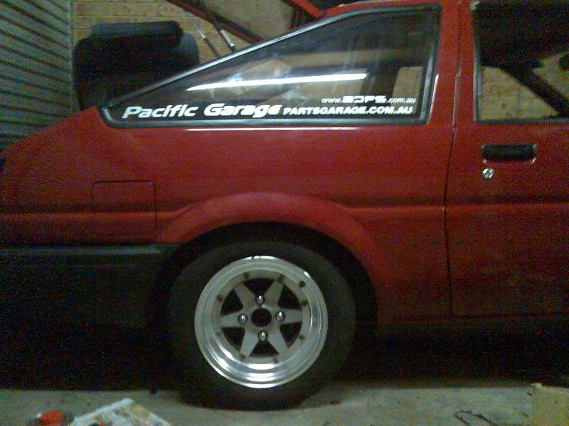

got a little more done on the car today, I have nearly all the interior floor painted with the deadner removed(it's going to be fukn loud in there) and threw a few stickers on the window (madhouse represent )
also got the oil cooler mounted and hooked up
here's a few pics
interior paint:
oil cooler through cut out front bumper
and a couple o stickers

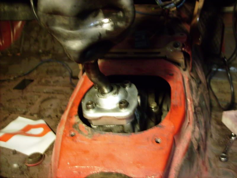

UPDATE!! 20/8/07
got rear end pretty well completed, will have rotors in 2 weeks for AJPS then it will be ready to go in the car, wont put it in yet as its a prick to push with a CIG in it haha, also should have dizzy cover ready by the end of the week, i kinda broke it so i gotta fix it, getting flywheel machined this week so i can put clutch on and then motor and box should be mounted by the weekend and hole cut back a lil bit for shifter to come through, thats about it for now, heres a pic of the rear end, more pics later in the week when motor and box are in, enjoy
