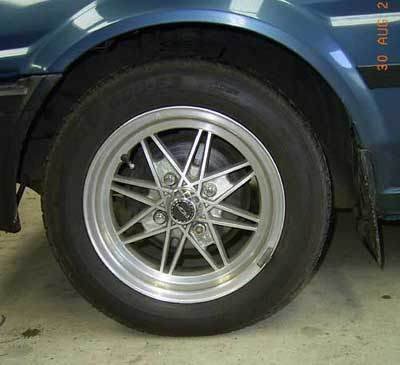

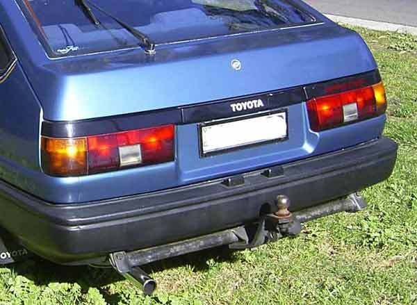

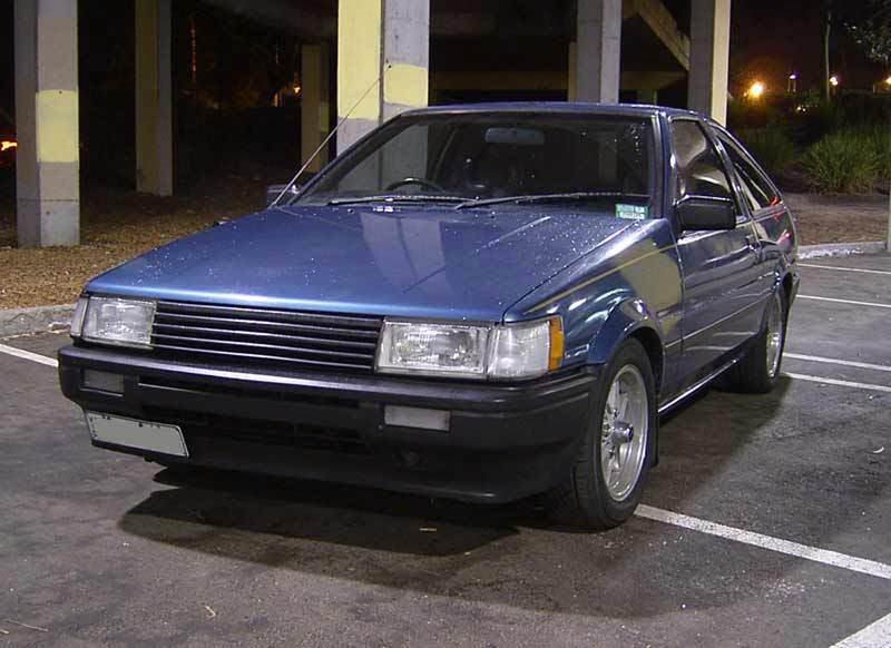

    Heres what my car looked like when i first bought it:
    Now one of the first things I did was to take the imobilisor off to put an alarm with remote start on, When I take everything apart I found 2 complete imobilisers and I was left with this nightmare half way through:
    That ball of black wires to the bottom right was the main one that was in use, I took it out carefully and is now installed on my friends Sylvia. I will never do an alarm ever again!
    Next up I had to do something about the height, it was beyond a joke so I lowered it, heres a before/after:
    Bye bye 4 x 4, hello to it being dropped to the floor! And remember kids always use a safe and legal method to lower cars (hides angle grinder )

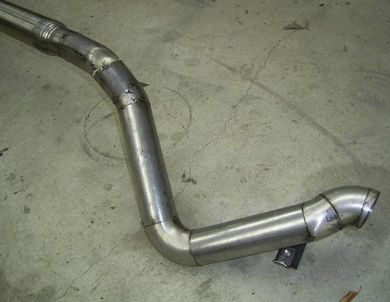

    UPDATE: This was for when I was aiming to have a 4AGZE turbo hence the large pipe size, this is now very regretfully for sale.
    Over the last few days there has been a strike with a picket line at my work which I was expected to be on, so what do I do? work on my car of course! Anyway I started by moving my original exhaust so it doesnt cross over from one side to the other and also so that it finishes before my diff. This leaves the other side completely free and allows my new exhuast to be fitted all the way to the back of the car. It starts as a 3 inch pipe and just before the diff it reduces down to 2.5 inch, all stainless, all equal length diameter bends and with no burrs or steps or intrusive welds.
    It took me like 3 days of tedious work but heres what I ended up with:
    thats the 3 inch flex pipe at the front which I am hoping wont melt as I am expecting for part of this exhuast to start glowing red at times.
    Heres after it has reduced to 2.5 inch where it goes up and over the diff, this part alone took me so many hours. That handbrake cable will obviously need to be held well away.
    Taken out of car, notice the reduction in pipe size, although it looks bad on the outside the inside is nice and smooth and ontop has been ground and sanded for even better flow. On the end of this pipe is where I plan to attach my 2.5 inch stainless magnum stainless straight through muffler. If theres wasnt a turbo at the start of this it would be unbearably loud.
    A view from the inside, notice how theres a pair of grind marks on each join to match the pipes together, this is one of the reasons it took so long. As for the top while it looks like thres a step there there really isnt, its just an optical illusion.
    I only tack welded it together for now, that because if I weld it fully not only will it be rough and potentially burn though it but it will also be gaurenteed to leave weld protrusions on the inside. So when I can I will be getting a friend to Tig weld everything together.

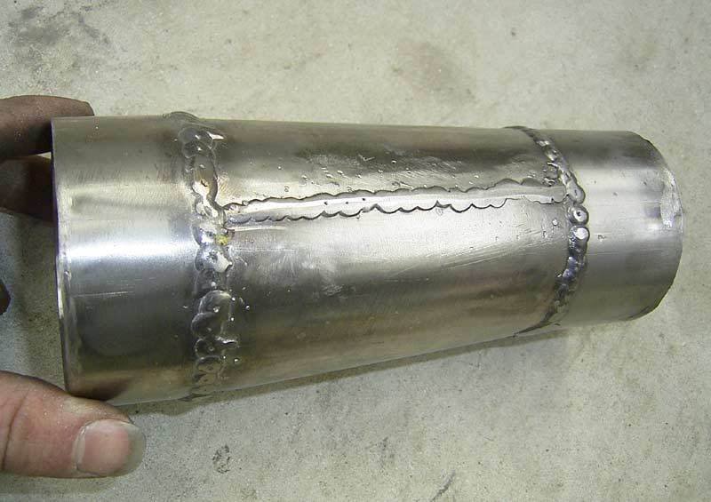

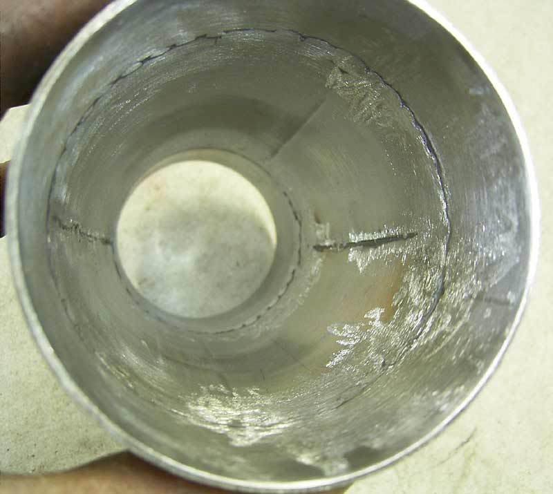

    I know have one less problem! I managed to make a 3 to 2.5 inch reducer, it was suprisingly easy and most of the time was doing some internal die grinding to get it smooth. The difference over my previous one is dramatic, I dont know how many degrees it tapers down but its not much. took about 3 hours which for me isnt much compared to how much I was going to spend on it.
    What i did is get a 3 inch pipe and mark out the sections needed to be taken out to make it taped down to 2.5 inch. I cut those sections out and then welded it, I ended up with this:
    I welded the whole thing myself because I can get to the inside to grind it which I did do to grind it smooth with my die grinder.
    after that I did some more cutting and shaping before welding the end fittings on, heres the result:
    it doesnt get any more gentle than that!

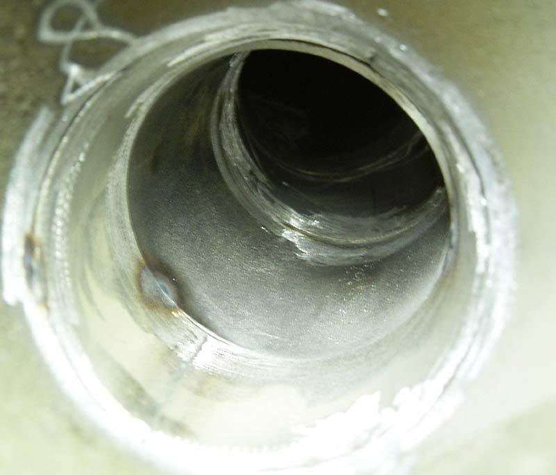

    I spent ages making the inside as smooth as possible with no steps at all, heres a pic:
    it still looks a bit rough but running my finger over it its all very smooth with no protrusions

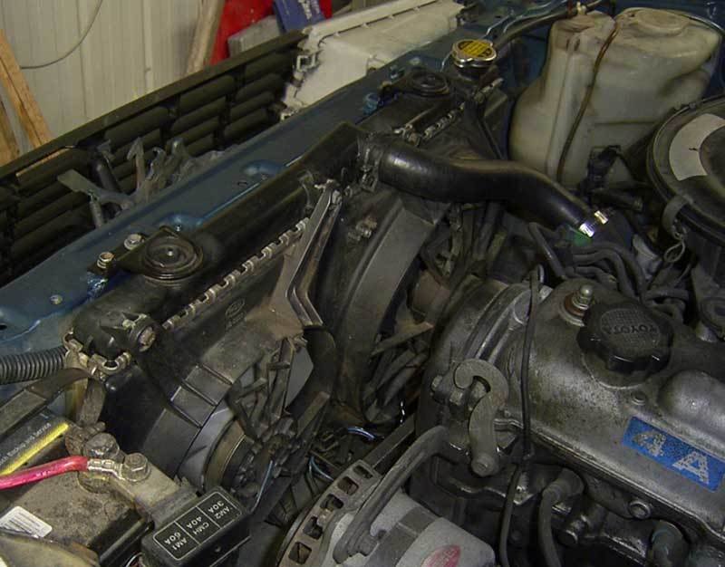

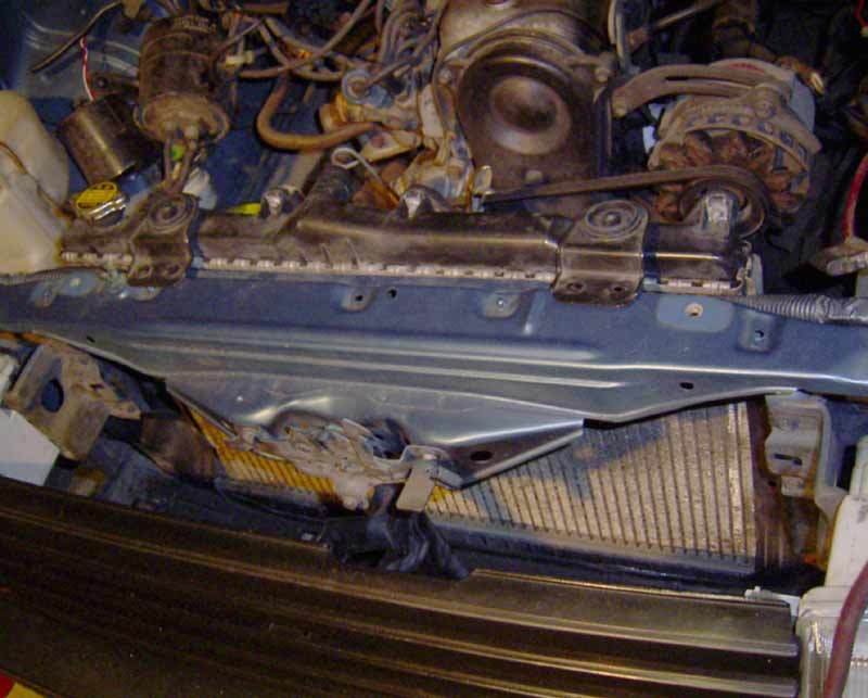

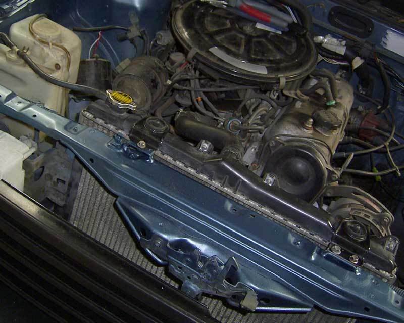

    I picked up some more bits from the self serve wrecker today, here they are:
    a 1991 Hyundai Excel radiator with fans and...
    an AE-82 corolla remote thermostat housing. I need this thing because the cooling system on my engine is designed for the front wheel drive layout it used to have. So when I convert it to a RWD I cant use most of the existing cooling system. I need this to put a thermostat inline.
    I bought the radiator to upgrade my cooling system as a just in case measure. As a bonus I should be able to sell my old one off easy enough. I normally dont go in my garage much on a Sunday but I had a quick tinker and I managed to do a dummy fit. As advised by the toymods forum the excel radiator was a good match and they were right, the results are shown below:
    To fit it I chopped off the original mounts on the car bodywork and I will be using the original Hyundai mounts. Looking at the pic the mounts are just sitting there, I will need to attach them somehow, but thats easy. For the bottom hose I used the original sprinter item which was a very close fit and with the hose being pre-heated a bit with the heatgun it went straight on. The top will require a bit more attetion but still it wont be too hard. Overall the radiator is a few CM longer, a tad higher and almost twice as thick. So it would have almost exactly twice the volume. Also the cooling fan setup is significantly better. I will need to work out how to control the fans, in the meantime I will have either nothing or a manual over-ride.
    Also of note is that I managed to lower the radiator, this means I then use up more of the opening on the bottom and it will mean I can effectivly sit the intercooler lower.
    The bottom hose had already been taken care of, but on the top the inlet of the radiator and the outlet of the water pump were different sizes. I did however notice that the hose from one very nicely slid over the other. So what I did first up is use part of the sprinter OEM hose for off the water pump and the Hyundai one off the radiator, I trimed them down untill they fitted together nicely with them overlapping each other i the middle. I was happy to find it fitted very nicely together. From here I choped off an aluminium peice of pipe and jammed in into my smaller pipe off the radiator, again with some assistance from my heatgun. Like so:
    from here the larger hose slid over the top and the aluminium insert was used to provide a support for the hose clamp that held the two together. Besacuse I had to use the heatgun to put the incert in I wont ever have to worry about it moving around, it just in there way too tight.
    After it had all been done up:
    There, looking like it was made to be fitted that way!
    I made the brackets that the Hyundai OEM radiator mounts will screw into. I welded them on and spray painted them from an expensive colour matched metalic spray can I had laying around. Also as per usual I used toyota OEM bolts to hold it down to further the original look and practicality. Heres how it looked:
    Also notice how the oginal overlfow bottle hose on the top left looks like it was made to fit on.
    Lastly a pic from the back showing how nice it fits:

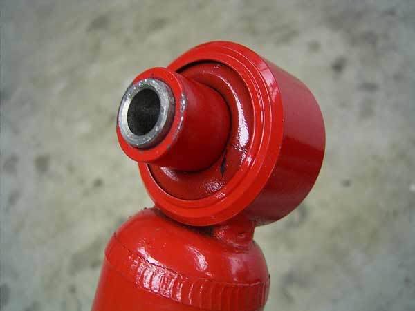

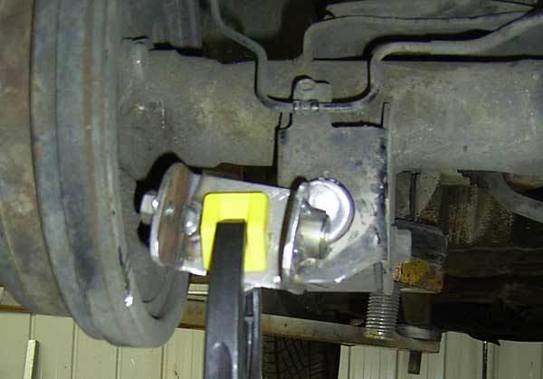

    I installed my rear AGX shockers into my car. Heres how I did it:
    This is the orginal design, an eyelet style with a bolt through the middle. The shockers I am fitting are almost identical with the exception of a 40mm shorter stroke and with a different bottom mount.
    The Commodor used a realy primitive and stupid setup to hold the shocker in, its held in by one side only with a bolt thats aproximetly 13.5mm in the shank. To comensate for the pathetic design they used a big, heavy cast iron mount to fix it to. If that wasnt stupid enough they used a bolt with a rolled thread and a shocker that has a 15mm hole in it. So basicly all Commodors have heaps of slop in the lower mounts and rely on bolt tension to hold them captive. So what I did is get a spacer machined up which I pushed in. This is to reduce the diameter from the 15mm down to suit a common 10mm bolt. I decided to have a single bolt going right through.
    Heres the deisgn I came up with, it uses 3mm plate. It uses a 10mm hex head bolt with a cylender shaped head. To stop any slop forming I welded a nut on one end and put a thick section of pipe to support the head at the other end. So I have the equivolent of about 10+ mm of material at either end of the bolt. Very simple, light and effective. In this photo I had chopped off the original mounts and was ready to weld mine on.
    All welded up and painted. Looking here you see that I drilled 4 holes through the middle which I used to weld, I also welded from all the edges.
    This is the top, the shocker was the same at the top however the bushes supplied with it were slightly different. Fitted into place the bushes show themself to be larger but it isn't a problem. To fit the covers I just pulled the inter peice of trim up a bit to clip them on. Once in place its indistinuishable.
    All finished with the shockers mounted and ready to use.

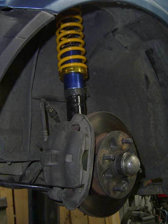

    Another thing I have made/assembled/fitted: my bigger brake coilovers:
    The specs are as follows:
    *ST-204 Celica GT4- KYB AGX 4 way externally adjustable shockers.
    *MA-61 Celica Supra Brakes- 280mm vented disks with a massive calliper.
    *RA-28 Celica struts- shortened 60mm with bottom seat replaced with Fulcrum 65mm coil-over collars. Also bottom side ground down partially to make clearence for brake calliper.
    *RA-28 Celica brake caliper mounts: Severly modified to be used a a new mount for supra brakes. Original plate was cut right down and a new design mount was welded in place.
    *RA-28 Celica spring tops: Severly modifed to not be a spring top anymore but instead be a retainer for the new aluminium coil-over spring tops.
    *AE-86 strut tops
    *250mm long free height, 150 pound King Spring- This is no good for me and will be replaced by a 200mm long, 325 pound King spring.

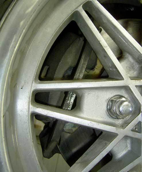

    Notice the lack of clearence between the caliper assembly and the rim, theres approximetly 4 to 5mm gap:
    This isnt finished, heres what I plan to do still:
    * I have had some ADR approved stainless steel brake lines made up for better feel so I plan to fit them once I am used to my better brakes so I know what the difference really is.
    * A new custom clamp for the brake line on the strut.
    * Paint the callipers in some 1200 Degree paint (red) I have.
    * New brake pads. the current ones are like new but I want some sport pads for increased bite.
    * New camber tops to allow for that adjustable camber which is missing from the factory. I will look for alternatives before using this as they are very expensive.
    * 200mm, 325 Pound King Springs
    Heres my custom brake brackets, it was very hard to take a decent shot of these so I had to touch it up heaps in photoshop, hence the noise.
    I shaved a bit off the bottom of the strut where the red arrow is pointing. That edge used to be rounded between those two bolt holes, hence why there is a step that comes up. As u can see it was shaved back to make room for the plate that the caliper is supported by. From the photo what I did looks rough and not that strong, but it's quite the oppersite. I made it just about indestructable and then suported it a bit more.
    For the brake bias its an issue that many overlook. Right now I have too much front bias, as in the front will lock up too early. I will fit a Wilwood brake bias adapter to whichever line needs it; front or rear. It needs the restriction on the front right now but that may be reversed once I fit the rear disks with the new diff. So I will wait till that is fitted and then see what happens. Its funny to hear that someone could pay $2500 on a rear disk conversion and then have bad braking power.
    Also another shot of my new brakes, here u can see how my caliper is a nice fit and also how the disk hasnt been worn in yet. Also I have since painted the calipers red.
