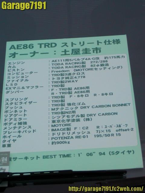

if someone can translate this?
does anyone know the detailed specs on his 20v gtv trueno? engine and susp wise?
doesnt say too much on the vids ive seen. cant really find much info otherwise
That tells you most of it there.... no translation really needed.
I mean its not specific down to the tip of the needle, but most of it is written there...

found some info on ae86 club vol.7 video
Keiichi's AE86 Specs:
Base 1986 AE86 Sprinter Trueno GTV

pics of this thing should be added to this thread:
rough translation:
ENGINE: AE111 5 VALVE 4A-G MODIFIED APPROX. 175 HORSEPOWER
CAMS: TODA RACING 272/288
PISTONS: TODA RACING 82 FORGED(?) THIS ONE, I'M NOT SURE. SORRY.
COMPUTER: FREEDOM (MOTORE SETTING)
(TRANS)MISSION: TRD 3SPD CROSS(I THINK THEY MEAN "CLOSE")
FINAL: GENUINE TOYOTA 4.778
LSD: TRD 2-WAY
EXHAUST MANIFOLD/MUFFLER: TRD
DAMPER: (F)TRD AE86 APPLICATION (R)SAME
SPRINGS: (F)8KG (R)8KG
STABILIZER: TRD
BUSHINGS: TRD REINFORCED/STRENGTHENED RUBBER COMPOUND
HOOD: M TECHNIC DRY CARBON BONNET
REARGATE: TRD N2 APPLICATION
DOOR/SIDE MIRRORS: ****SUA(SITSUWA?, I DON'T KNOW WHAT THE HECK NAME THAT IS) DRY CARBON
BODY REINFORCEMENT: TOKYO KAGAKU TOSO INC.
MAINTENANCE: MOTORE
BRAKE PADS: IMAGE (F)C2 (R)SUPER SPORTS
WHEELS: DORI DORI MESH 7JX15 OFFSET-2
TIRES: POTENZA RE-01 195/50R15
WEIGHT: APPROX. 900KG.
The bottom is partially covered, but I believe it says Tsukuba Circuit. Followed by Best time: 1' 06" 94 (S Tire).
Not a 100% translation, but pretty close. Hope you enjoy.
