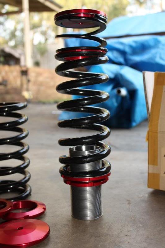

and also purchased a HSD sleeve kit, 8kg springs and helper etc.

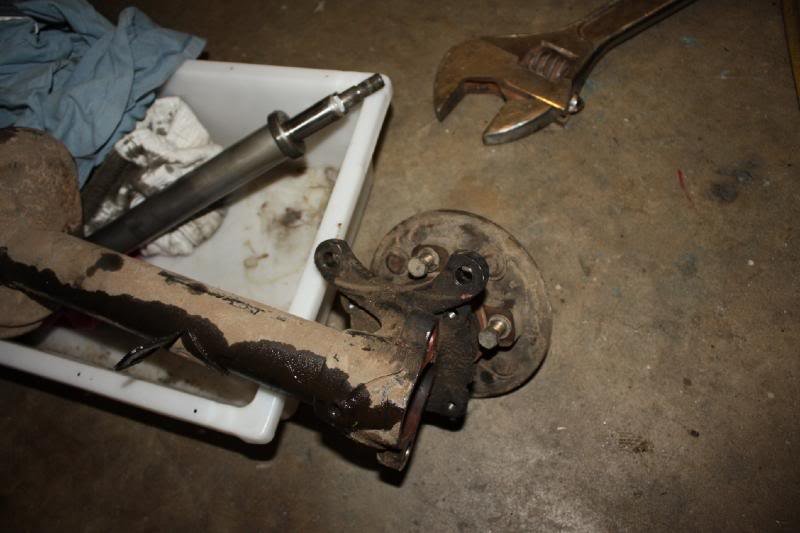

Struts pulled appart

Sleeve kit : 200mm free height + helpers

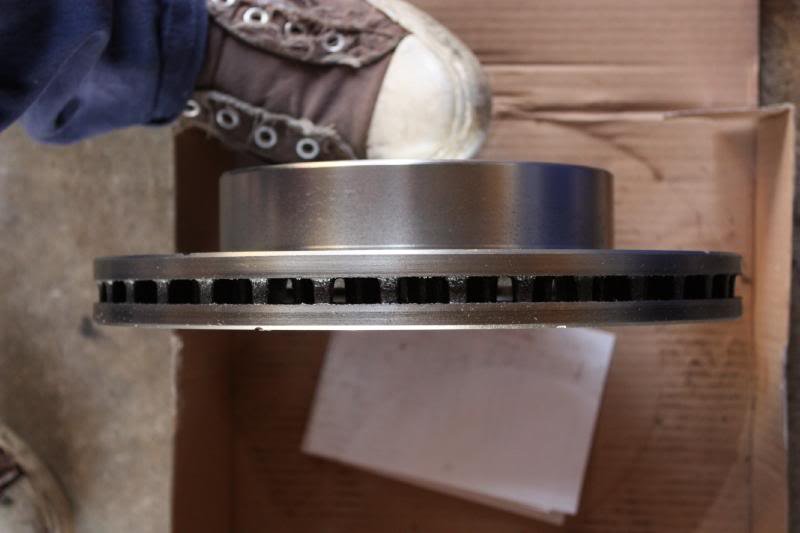

i had the ultimate setup all planed, with a few days of searching the DBA cataloge over and over,and countless times of measuring and re measuring, wanting to mount the rotor in the stock inboard position, i came across the perfect rotor! was from a lotus elise S1 with dimentions of 280 x 29 x 29 pretty much no hat at all.. only listed in 5000 series i called up and got quoted $450/ roter!! it would still work and ive got it all drawn up but it majorly blows the budget!
anyway the cressida boys use R33 calipers with BA falcon rotors, but i had R32 calipers that take a 280mm rotor, so more searching and BINGO!! found a 287mm rotor 28 thick and 65mm height.
scored these from RDA for $180 the pair and their slotted aswell!!
brought em home double checked some things and then took them to re drill the PCD, $50 for the pair! much bettter then the $70/rotor prices i was getting earlier in the day..

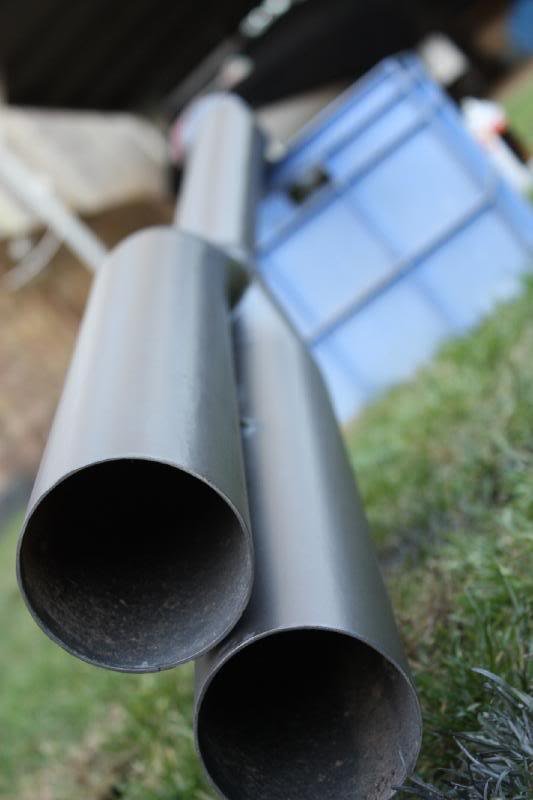

Also painted up my exhausts system
as you can see below the 287mm rotor is just a bit tall for the R32 caliper
(factory 280mm) so ill need to mill it down about 2 mm

and exhaust

you talking about your one's cal? cant u get the big lock nut off ? i had to put the strut in a vice then i have the biggest shifter u have ever seen, its about 800mm long, i found if i tightened it first then tried to undo it, it worked, u need some big force to get them off.
try getting some heat into it aswell, it will cause the strut tube to expand a little and help it release from the nut.
as for cutting and shutting etc, yeah im doing it to mine, im getting an alignment sleeve made up so it can be all welded back together properly
