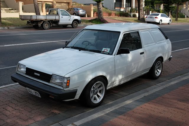

bought this as an early birthday present to myself.
i've wanted one for years so i decided to bite the bullet when this one came up for sale.
the day i bought it -
stock as a rock.
how it sits now -

let me know what you think.
