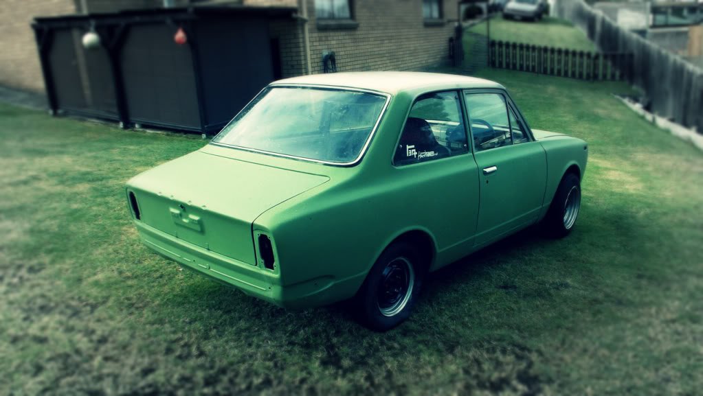

And here is where it is 10 minutes ago
The colour of the front guard will be covering the whole car as soon as the weather is ready.
The wheels up front are 13x7 widened datsun steelies wrapped in 165/70's soon to be replaced with 175/50's, Will have these at all 4 corners
The problem is it's unrego'd. So this car is being done in 2 builds. Rego passing and then the all out build.
After rego i'll be dropping in my chopped down ke70 crossmember and ae86 coilovers will be going in with p/s knuckles and rca's
The inside will be done from scratch including nardi classic, ma70 seats and a cobra fixed back which i'm yet to make rails for.
