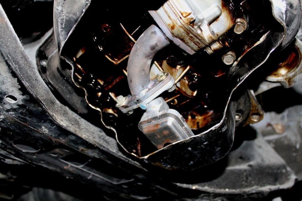

    Now I have extended the oil pickup to the lowest area of the sump.

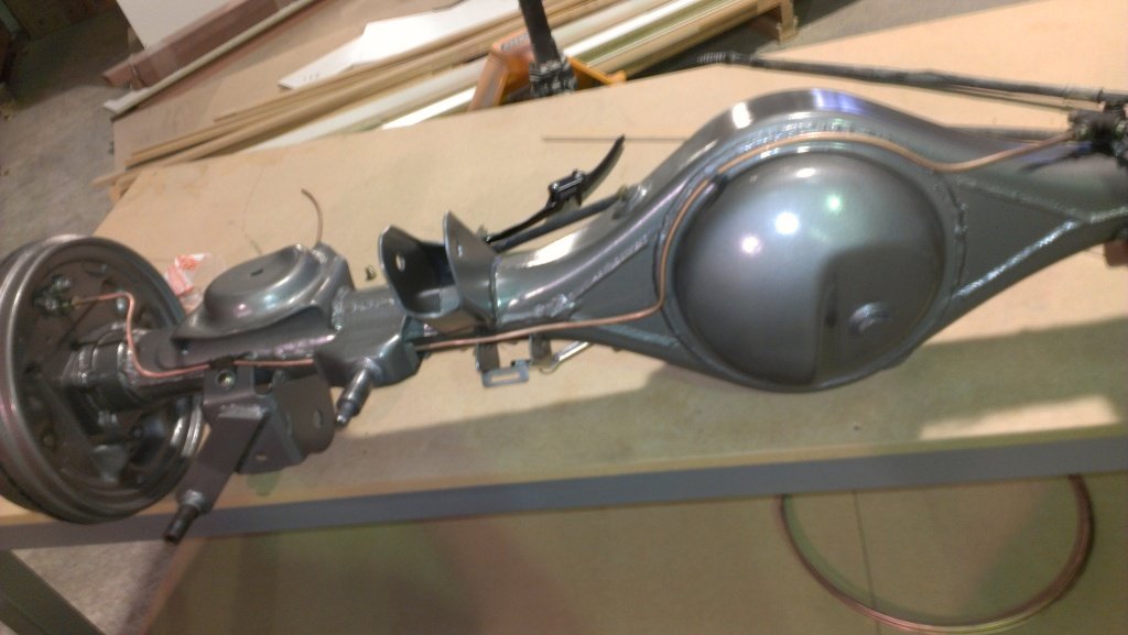

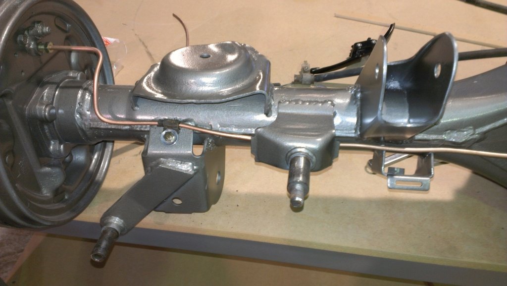

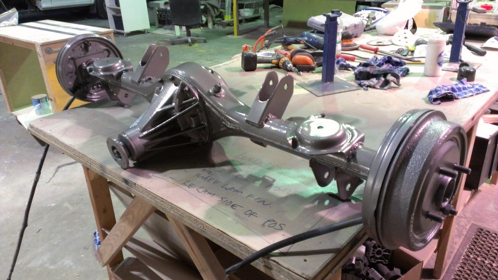

    So the diff is an MX13 one. It has had a type 2 lexus IS200 torsen lsd centre fitted with the original mx13 gears (3.9). This combination didnt need a spacer under the crownwheel to be built like most say. Sam Q has just sourced me the press to fit baffles from a later diff housing. That pretty much completes what I plan to do on the diff for the time being, as the rear brakes have a few miles left in them, and it would be simpler to just get it running with those brakes till its OTR. Once the mods were done, I decided to soda blast the housing myself and I finished it with an etch primer and some gunmetal metallic hammer paint. Looks horn. I also bent up some brand new bundy lines for the brakes and installed brand new flare nuts too.

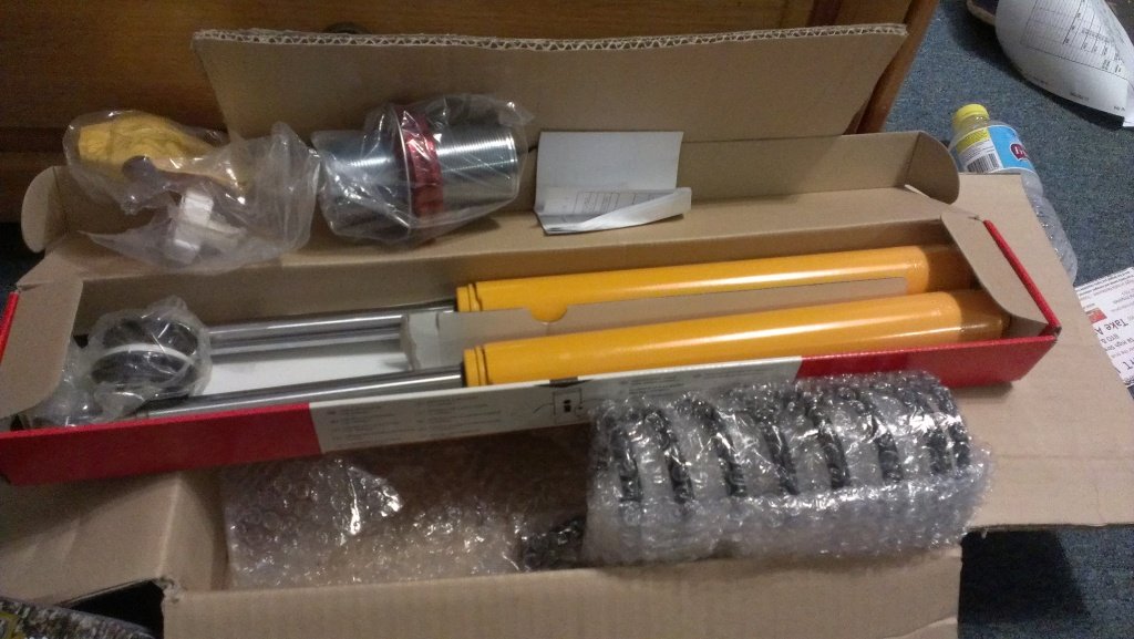

    I have also started on the front suspension. I bought a 6kg hsd coilover kit with the helper springs. I also bought sw20 MR2 Koni yellows brand new and some RA40 front struts/brakes/control arms. Im having them coilovered to suit the body length of the sw insert. The RA40 strut has a removable caliper mount like an ae86 or ke strut, which lets you make upgrade brackets without machining a cast xt130 caliper bracket back to square. Not sure exactly what will fit in the end, but I wanted the bigger bearing size in these struts as a base anyhow, and the rotor is bigger than a stock ae86 but slightly smaller than an xt130 rotor.

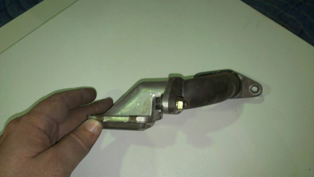

    I have been doing polishing and finishing where necessary. I've been reading and told that its better to polish oil galleries, so my mate showed me how to make an emery cloth polishing jug from an old screwdriver shaft and a die grinder. I have now buffed the inside of my oil extension pipe. Looks amazing. Its dead easy.

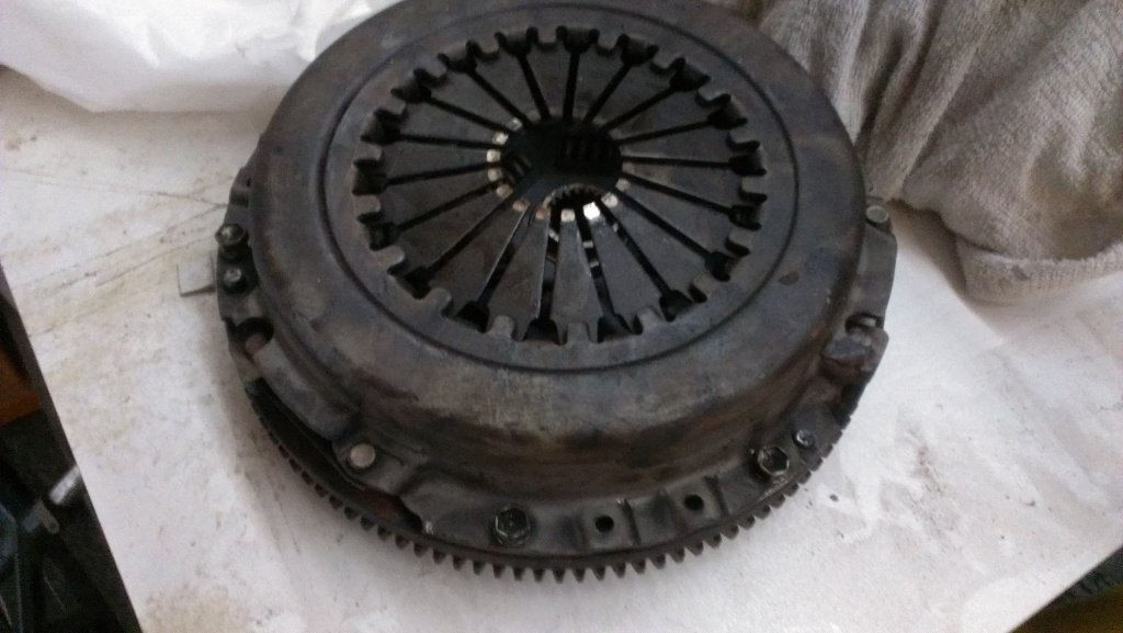

    I have given it a lot of though. I was obviously planning to use a Y bellhousing with a bigger than Y sized flywheel. The bigger flywheel fits in the Y bellhousing fine with the 2azfe clutch attached. However the kinda shitty part was the fact that you had to make a starter to fit the arrangement from 2 other starters and even then it was a finnicky thing as you had to flare a bolt hole 2mm to make it bolt up and there was potential for it to come loose and mislocate easily.
    I decided it was a lesser evil to go down one size in flywheel, use the Y motor flywheel that originally was supposed to go with the Y bellhousing ad starter. That way, its all stock parts except I will need to change the bolt pattern on a Y flywheel to the 2azfe pattern which is unique amongst Toyota motors for some reason. That way, once done, I can use an inexpensive clutch that is smaller than 2azfe, with hopefully less rotating mass once its lightened. It will have the obvious advantages of being set of stock parts that are easy to source as a set and cheap enough to bother.

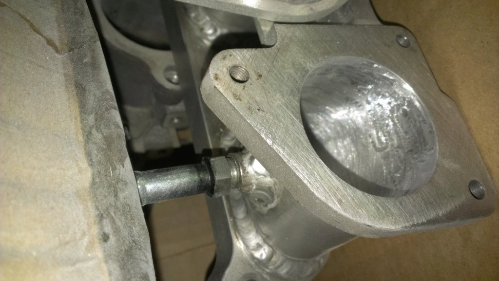

    Im going to do the emery hone trick on my inlet manifold also, but do it multiple times with finer emery so it ends up like a mirror everywhere above where the fuel is input. I want this inlet to really flowair fast as the pipe size has been kept minimal on the manifold for torque creation.

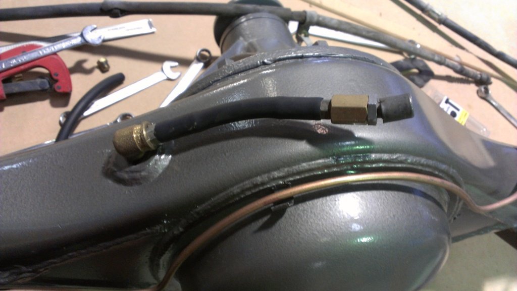

    Heres some piccys!
    The y flywheel clutch combo
    Oil Pipe and screen
    Inlet manifold with porting done, needs a polish inside
    Tensioner
    Front end parts
    Rear end
  6. #66

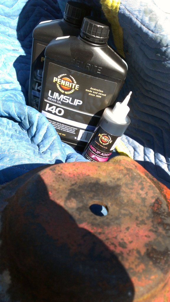

    Haha, the diff shop supplied the goods, and the bottle of friction additive also as part of the build. They said if I wasn't going to run baffles to put both bottles and all the additive in, drive for a bit, then drain some out but leave it quite overfull. I think Ill run it maybe 15-20% overfull and Ill be installing baffles. Sam Q has just found me some and will be sending them up soon. Legend.
    The tool is pretty simple, but effective as all hell.
    Just take any nice and straight screwdriver with a 1/4 inch shaft (most #2 phillips for example).
    Cut out the hardened shank and leave it as long as possible.
    Using an ultra thin cutting wheel, carefully slice down the tip to create a slot that emery tape can be stuffed in. Go as deep as you dare. Tip: It helps to use a phillips as the tip is more balanced when cutting and you can go diagonally into the slots between the cross as a guide for straightness.
    Then get a bit of emery paper and tuck it into the slot so it jams in there on the grit and then fold the edges opposite ways either side of the shaft to help hold it in there. Wrap the tape around the shaft a couple of times. It depends on your diameter of tubing that you want to polish as to how much emery tape you have rolled up on the tip of it. Make sure the tape isn't too coarse if you are doing alloy, as it will blow through it quickly if you lose focus. Use some crc to get a brilliant shine while you do it.
    Its important that the tape is a bit wider than the slot is deep, so that the tip of the screwdriver cannot score the inside of your tube. It must be wrapped and protected with enough emery paper.
    It takes a bit of practice to get the right amount of paper. Please put your tubing in a vice or clamp arrangement so you dont end up whipping your hand like I did, and wear eye protection. If its a short enough pipe you can polish one end while you look into the other, and make sure you enough light so you can see what you are doing. I buffed away 90 % of the pipe seams inside some steel pipe that had a 90 degree bend in it in about 3 minutes doing this, and this was with some worn out 60 grit. For alloy start kinda fine and lubricate it well, definitely dont try and use 60 grit.
