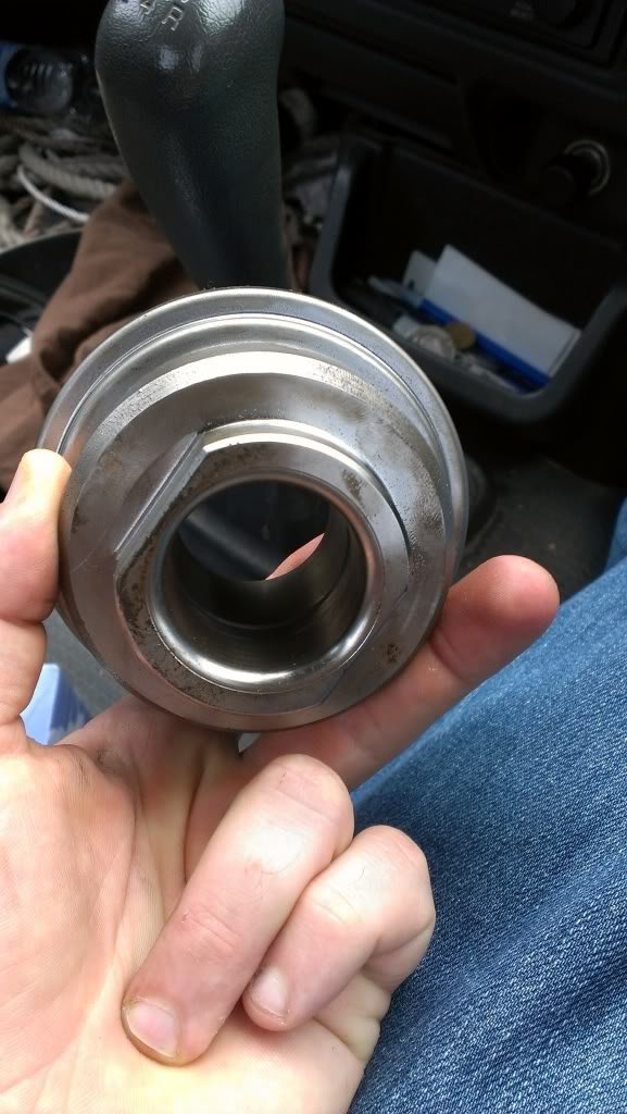

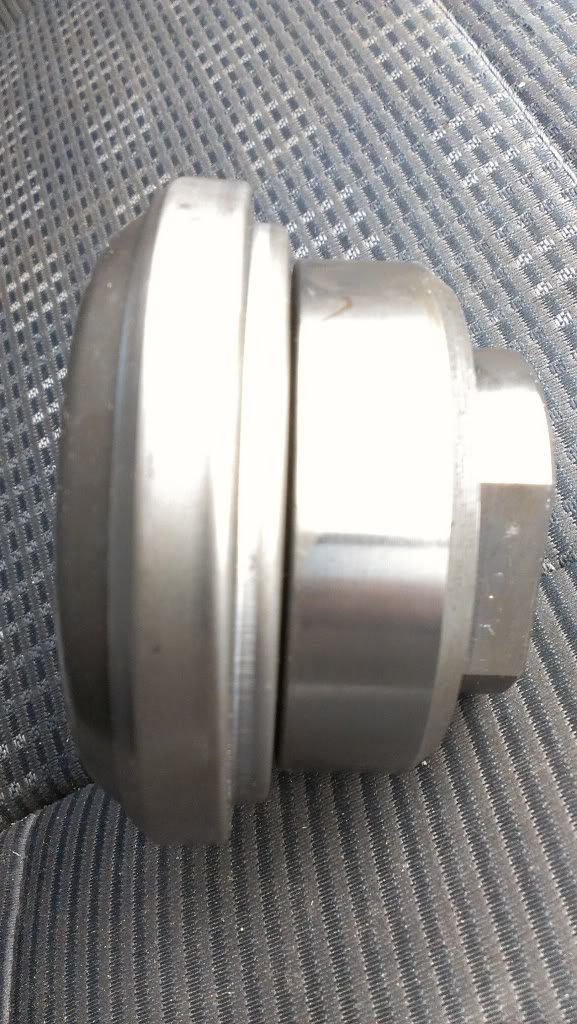

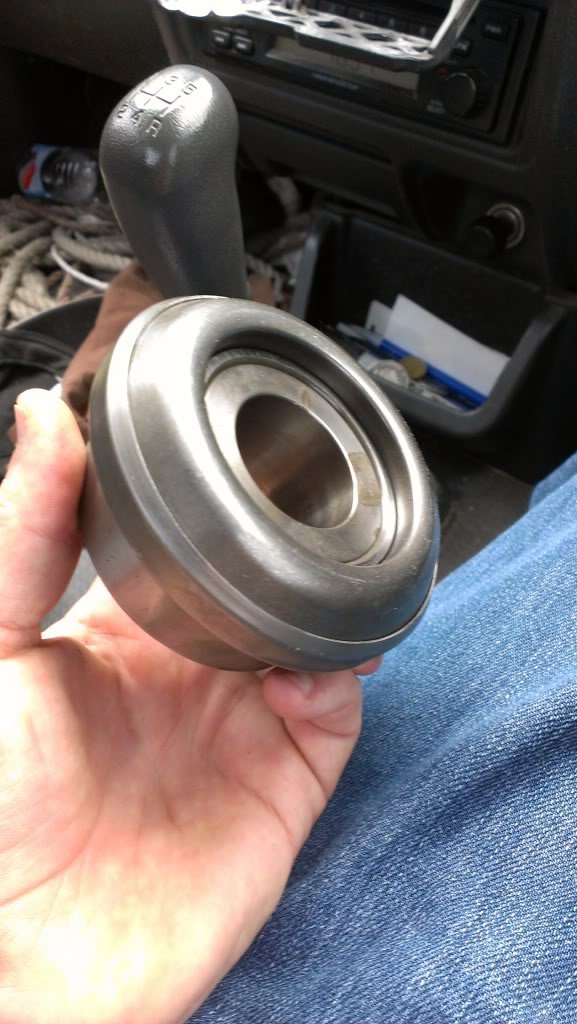

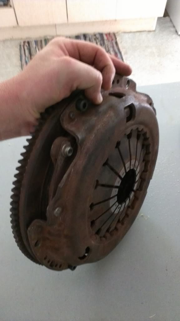

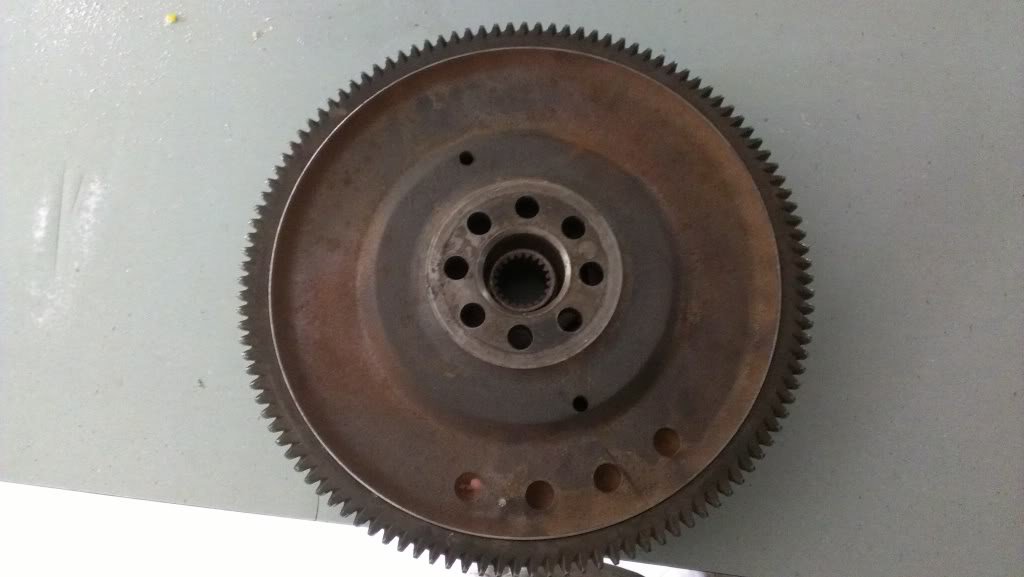

    I have the motor n box back with a slightly custom flywheel.
    Doug at NPC found it was easier to just machine down the 2azfe flywheel to fit the ring gear from the rwd Y series flywheel.
    This allows use of cheap and decently large 9.5 inch toyota clutches. Just like the nnew one I have with the flywheel, so saves a lot of money by not needing some different disc and pressure plate. Doug also mad a custom throwout bearing carrier and upgraded the bearing to a much larger dameter unit. So hopefully that limits my noise from the throwout with the bigger bearing. Im a bit over how Toyotas seem to always have a noisy throwout. haha.

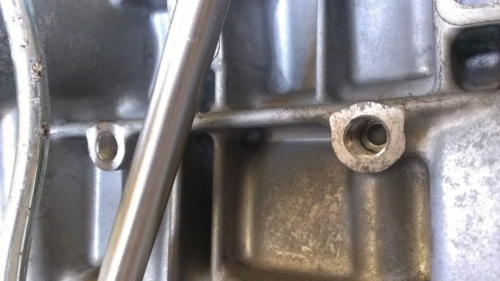

    Having the engine mount holes helicoiled today on the good block.

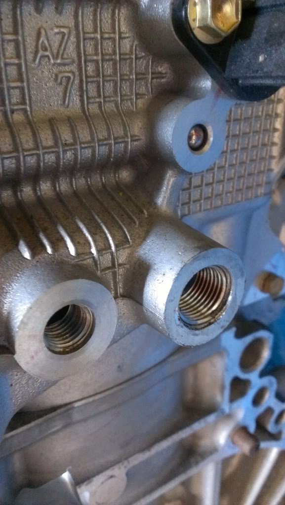

    Got lazy on the manifold and diff but I did have the block tapped and the heater port heli coiled for a banjo bolt.

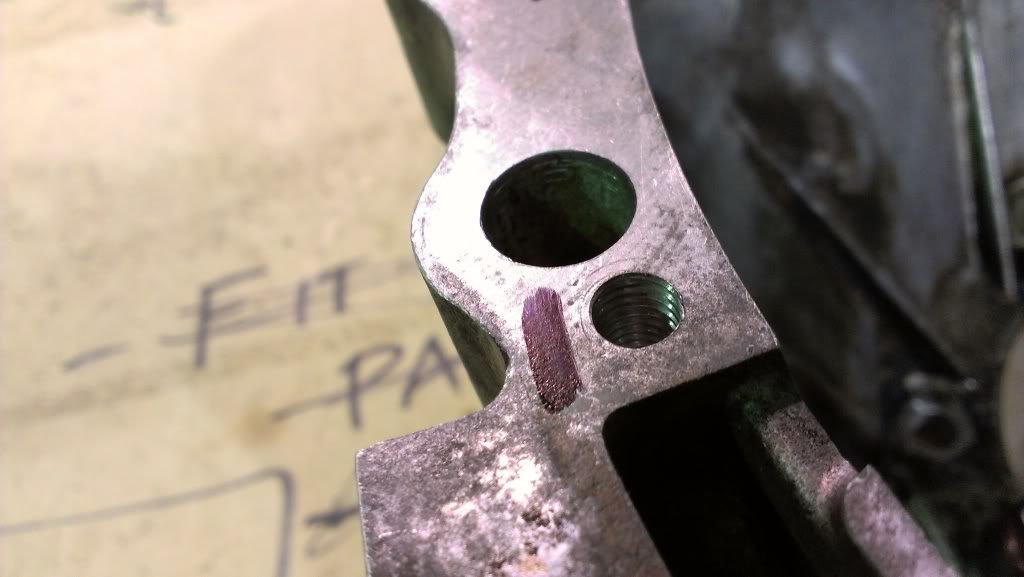

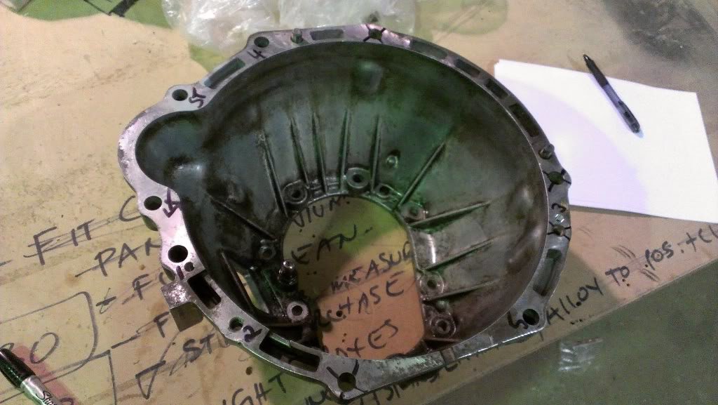

    Here is a better idea of the bell housing union. I drilled and tapped 2 x m8 and one m12 x1.5 thread to make the union. The x marks show unused holes. Numbered are used and st means starter mount holes. It uses 2 dowels and the dowels locate it perfectly centred.
    Bellhousing union:
    2azfe flywheel and clutch with 4y ring-gear fitted.
    Custom billet throwout bearing carrier and oversize bearing
    Heater pipe tugged out and helicoiled for an m16 banjo bolt to aide firewall clearance.
    Engine mount holes professionally tapped right to the bottom.
