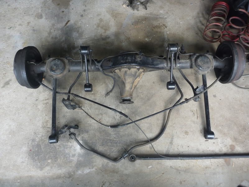

Update:

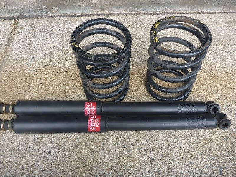

T series drum diff, TRD 2 way centre -
T50 G box -
Rear suspension - AJPS 6kg rear springs - (NOT USING SHOCKS, I have good Bilsteins to go in....

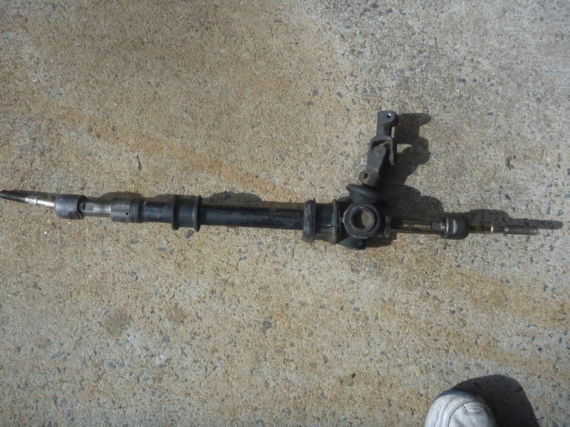

Genuine AE86 GTV steering rack (quicker rack, less turns lock to lock) -

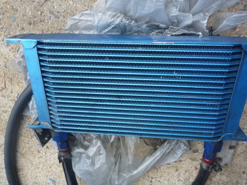

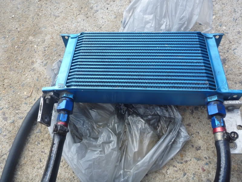

EARLS oil cooler -
[/SIZE]

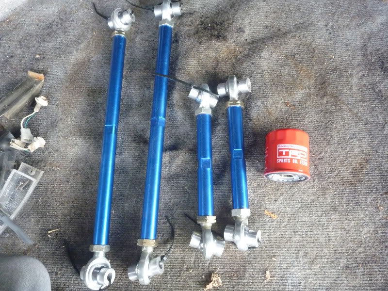

Genuine TRD oil filter, quality Australian made adjustable 4 link arms (teflon coated) -

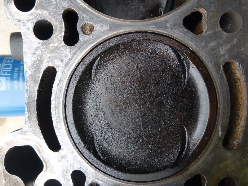

ENGINE BUILD:
Firstly, I have decieded to go with another turbo motor, mostly because I already have 80% of the parts for the engine.
Engine Specs:

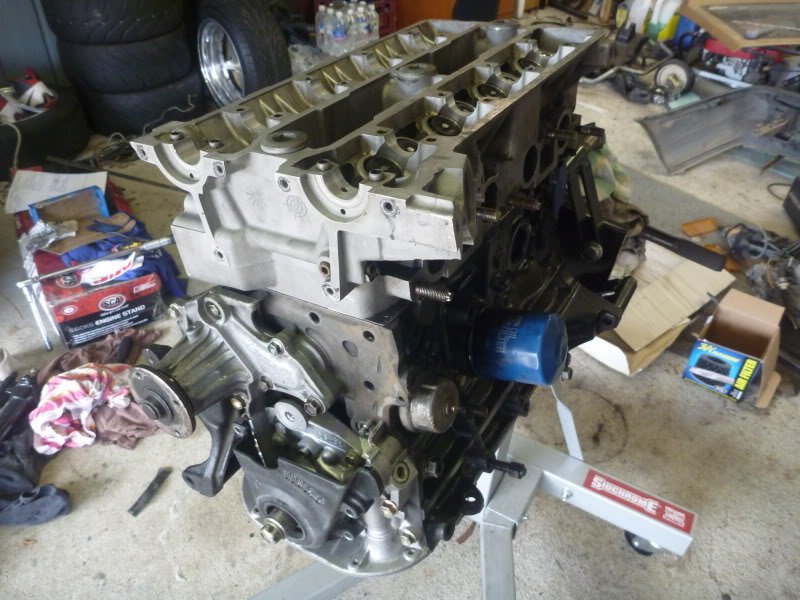

Smallport GZE bottom end, Modified/built bigport head specifically for a turbo motor apprantly by Pulse Racing in Sydney, (massive combustion chambers reducing compression, valves, exhaust porting 5mm), slight re-ground camshafts but I dont know the details of them, Toyota Genuine Full engine gasket kit throughout, Genuine Toyota Timing belt and new tensioner bearing, Genuine Toyota head gasket, re-conditioned oil pump, ARP Head studs, Garrett S15 ball bearing T28 turbo, HKS turbo actuator, 440cc injectors, modified/braced against cracking stainless steel low mount turbo manifold courtesy of Feint Motion Drift Team, Just Jap intercooler, Turbosmart Vee-port BOV, CAS, polished alloy genuine RWD inlet manifold, polished cam covers, polished genuine RWD water outlets and water pump, TRD oil filter, Exedy 4 puk clutch using the 212mm flywheel, ARP flywheel bolts. Engine is controlled by a Microtech LT10s ECU, Coil-on-plug system...
Here are some pics of the 4AGTE engine build so far.....

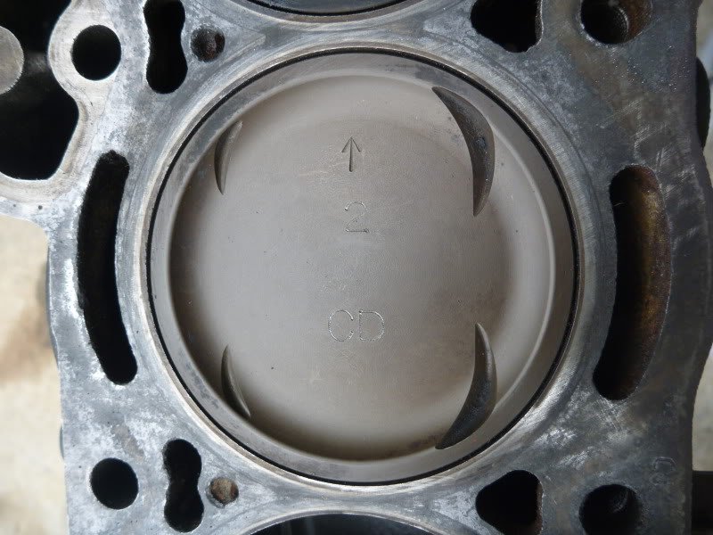

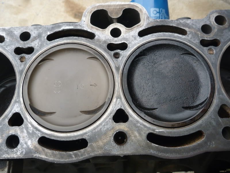

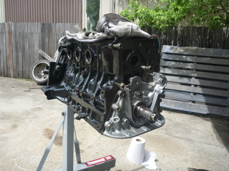

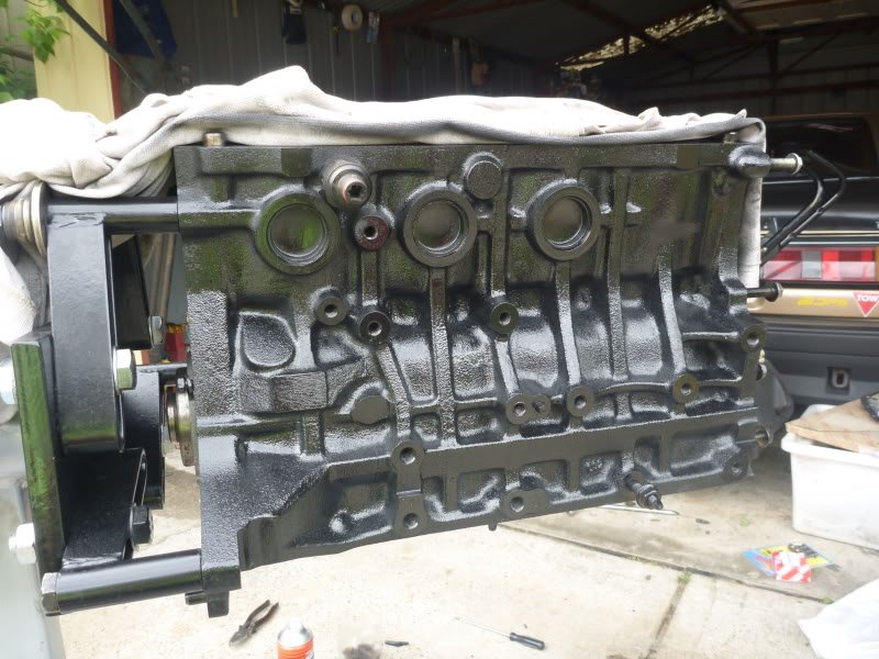

I gave the GZE bottom end a clean up and paint and fitted some new parts.
Before:
After:

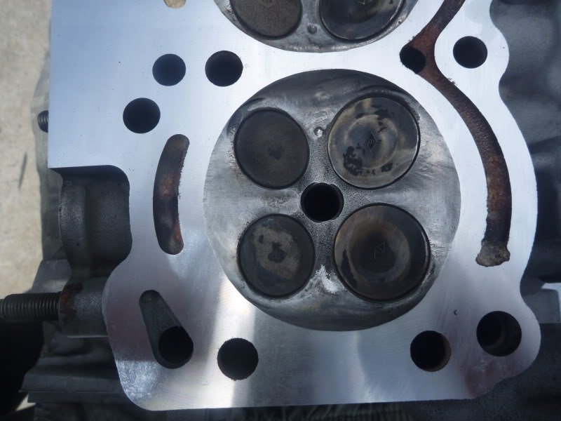

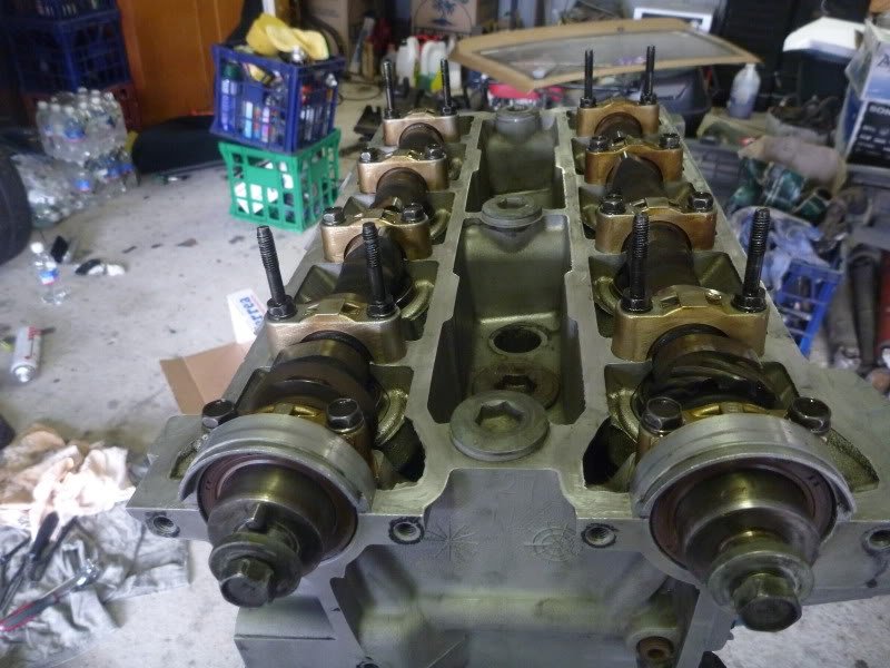

Modified head, just got shaved:

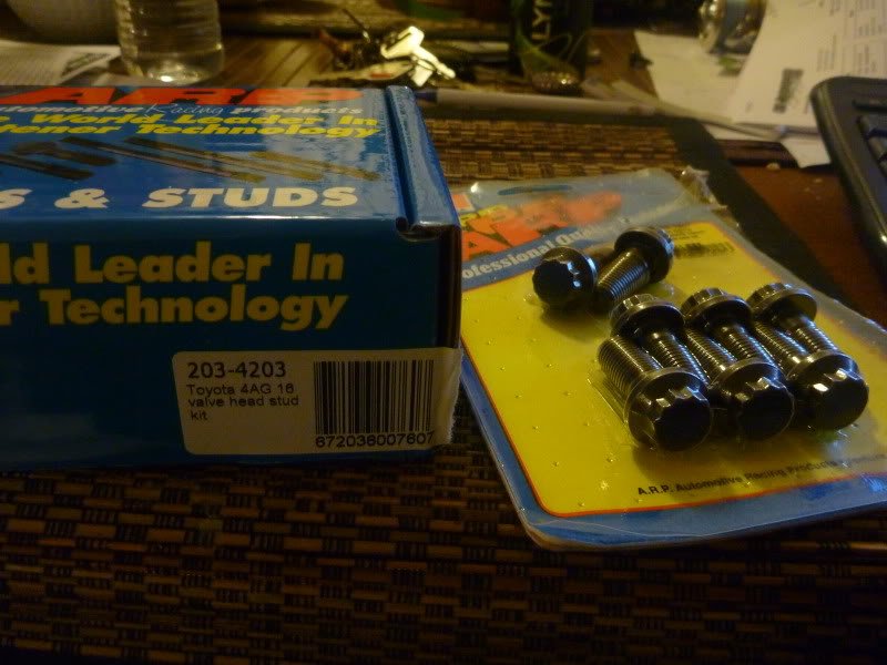

ARP Head Studs fitted:
Toyota Genuine Head gasket fitted:
Head torqued down:
Camshafts and new Cam oil seals fitted:
Cam pulley backing plate and cam pulleys fitted:
Toyota Genuine Timing belt, new tensioner bearing, and bottom 2 timing belt covers fitted:

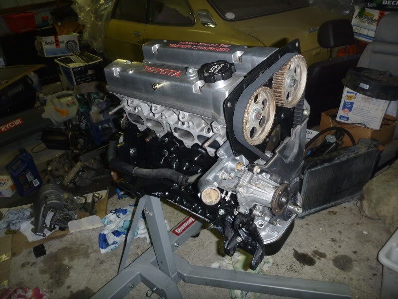

RWD water outlets, sump/baffle plate fitted:
Now starting to look like an engine....

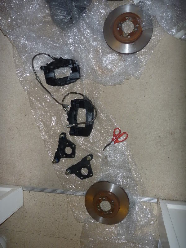

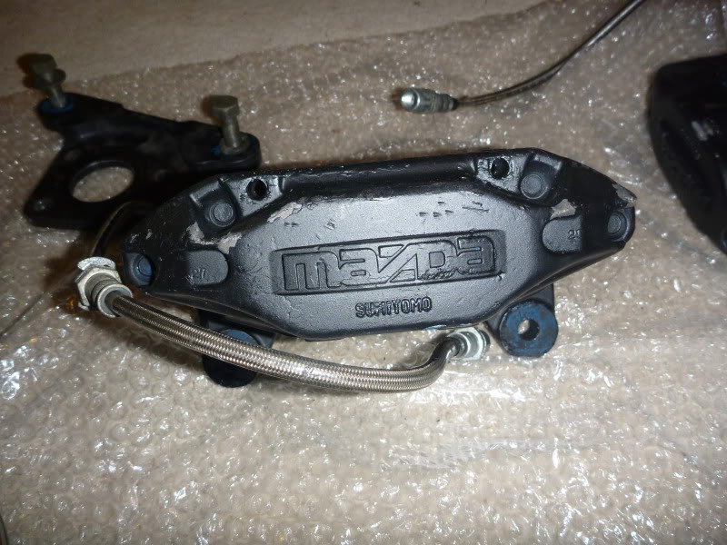

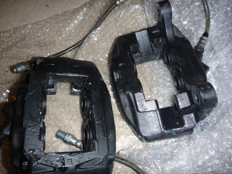

Front RX7 4 pot brake kit:
RX7 4 piston Calipers
AJPS bracket

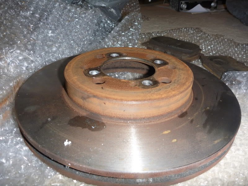

Rotors (civic?)
Braided lines
