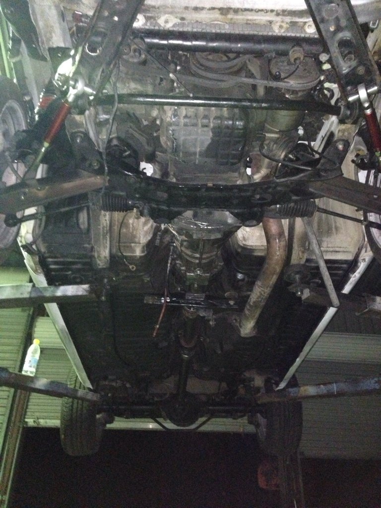

    got myself a vl manual tailshaft on sunday (both ends fit up). Pulled it all apart, serviced the cv joint and made a bracket to fit the centre bearing and will be shortening the rear half in the next few days.

    Dad must have got bored today while I was at work and decided to shorten the shaft.
    cutting on the lathe
    made it a tight fit and pressed it together
    when I got home i just grease up and reassembled the cv and put it all together

    got a heap of stuff done in the last couple of weeks, but mostly just finished off small incomplete things. connected up brakes and bled them up, welded up the cable mounts for the handbrake and put them together. tightened up all the suspension and steering. pulled the engine back out cut the shifter hole a bit bigger and made a plate to cover the rest of it. changed the oil pan to a tomei one i had, changed the oil and oilfilter pulled the turbo off and changed the gasket and gave the engine a good clean. also cut out the front a bit for the radiator to breathe a bit better, mounted up the power steering reservoir and ignitor and neatened the wiring up a bit. put the engin back in. put an exhaust up that im going to modify to fit. got my intercooler and started trying to see how im going to make everything fit
