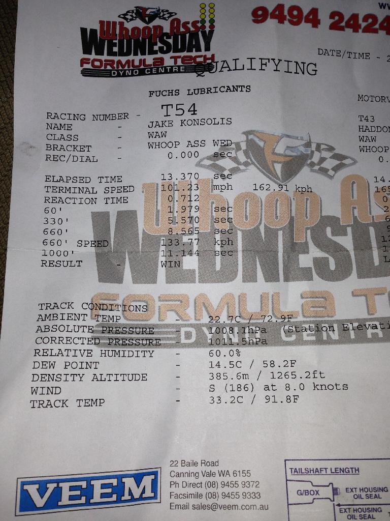

    took the car down to the drags last night to see what it would do while its still stock. Had a bit of a problem with a miss at high rpm but still managed to do ok. Learnt a fair bit and would like to go back soon when i have issues sorted

    3076? Mine is whistle central

    Apparently its those bleed veins on the inlet side that cause the whistle... Man they sound good though....
    PS low 13 is good, especially given you were having a miss!
    Should piss in 12s with the new turbo!

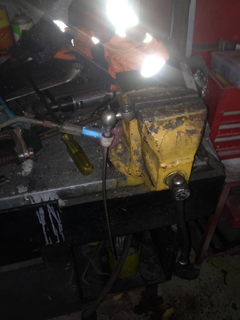

    Had a powersteering leak in the pressure line so decided to cut the old line up and make a replaceable braided line with JIC fittings to make it cheaper to service in the future

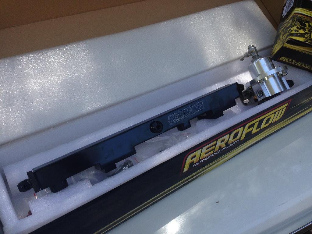

    Also while i was picking up braided powersteering line i got excited and bought a fuel rail, regulator and ordered some turbo lines

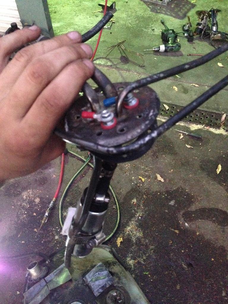

    did an intank lift pump setup today as i was sick of the sound of the low pressure lift pump

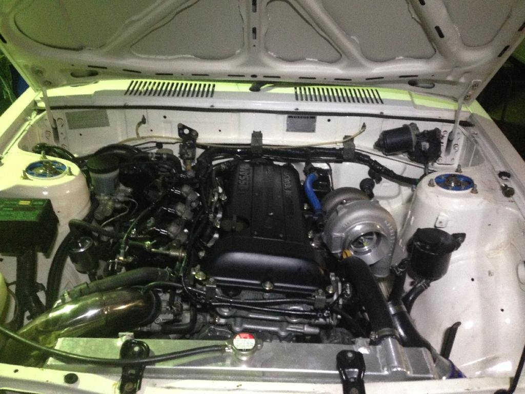

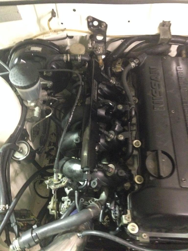

    Started assembling things on the car. put the turbo, manifold and lines on, also put the fuel rail and injectors on.
    also took the intake off and spent some time changing the loom to hide it a bit more
