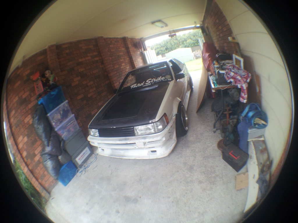

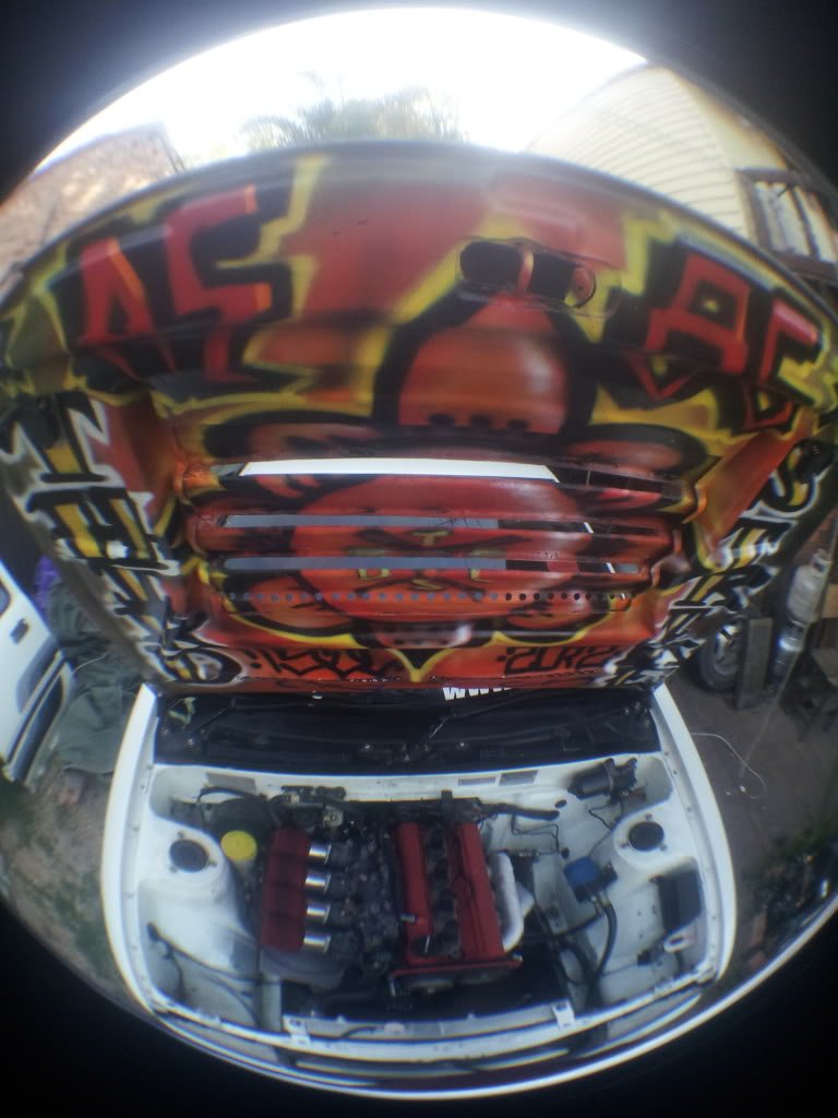

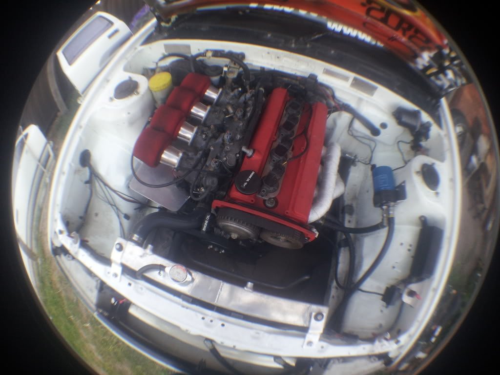

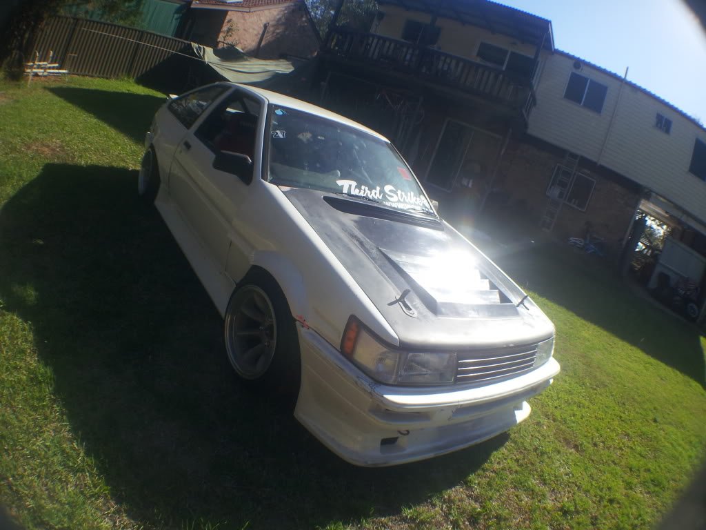

got some new lenses so took some happy snaps

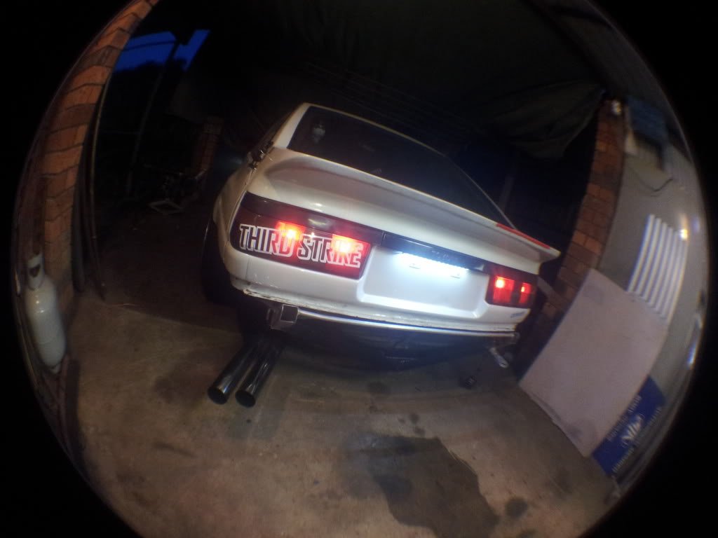

just another couple from tonight
