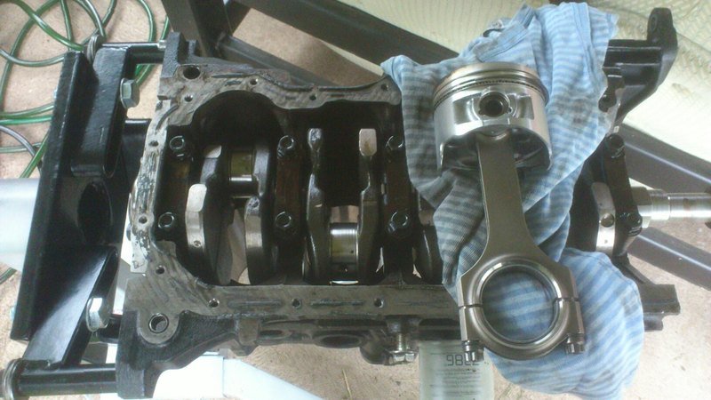

Also within the first two weeks went and bought a mates freshly rebuilt 7AFE block with ACL forged pistons and rods, ARP rod bolts, knife edged crank etc etc

The pistons are ACL 11.1 forged pistons on what I thought were also ACL forged rods, but am not too sure now. They are forged but unknown as of yet what brand
Have you worked out what the final compression will be with those pistons? As it will most certainly be higher than the advised 11.0:1 if in a 7age...I'd also say those cams are most likely too large for that kind of setup...

As for compression I havent worked it out, the engine was previously a mates who built the motor, ran it for 5,000km's and decided on 1UZ I bought it from there.
