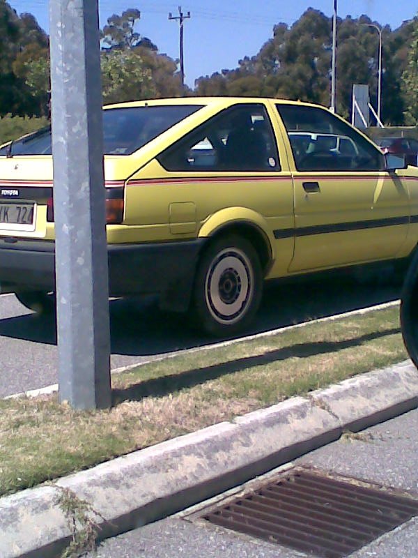

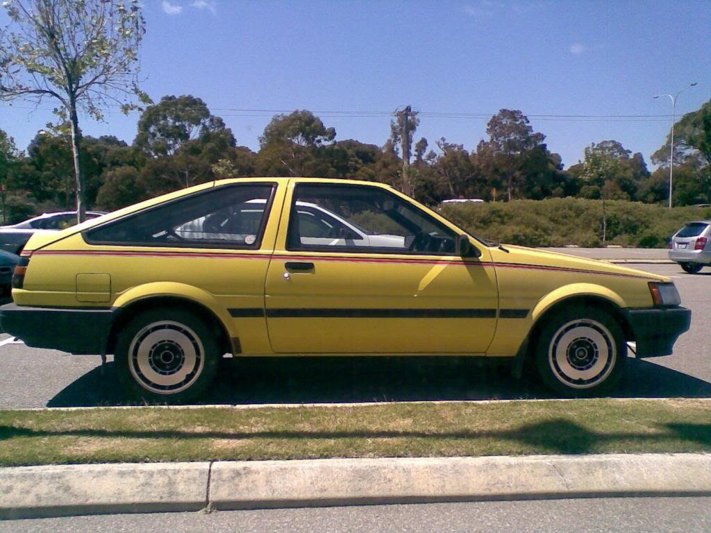

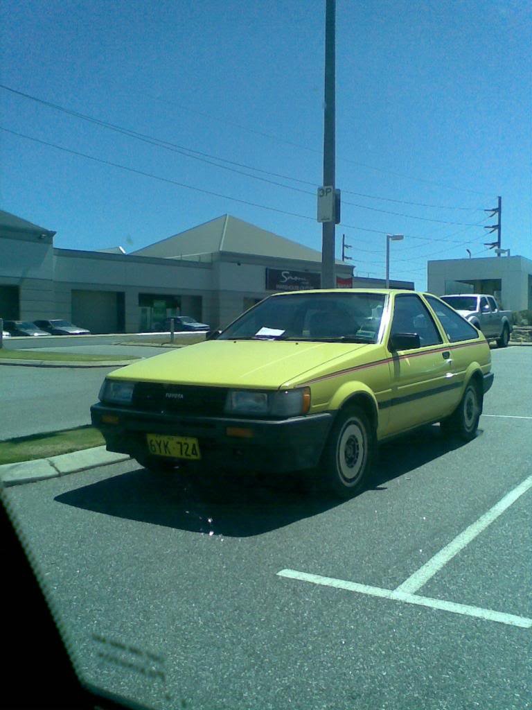

    Nice....
    I left a note on this about 4-5years ago in Joondalup....
    I wonder if I still have the pic from that day
    EDIT:
    Changed a little

    Hahaha that's awesome. I bought it about 2 years ago in that exact form. Pretty keen on seeing oldies of it. I've only got a few iPhone ones. Haha.

    Love the yellow! Yellow is best ha ha

    Hahaha yea diggin the yellow. Deffs looks good polished up. Mine needs a redo but, has a couple of off panels
