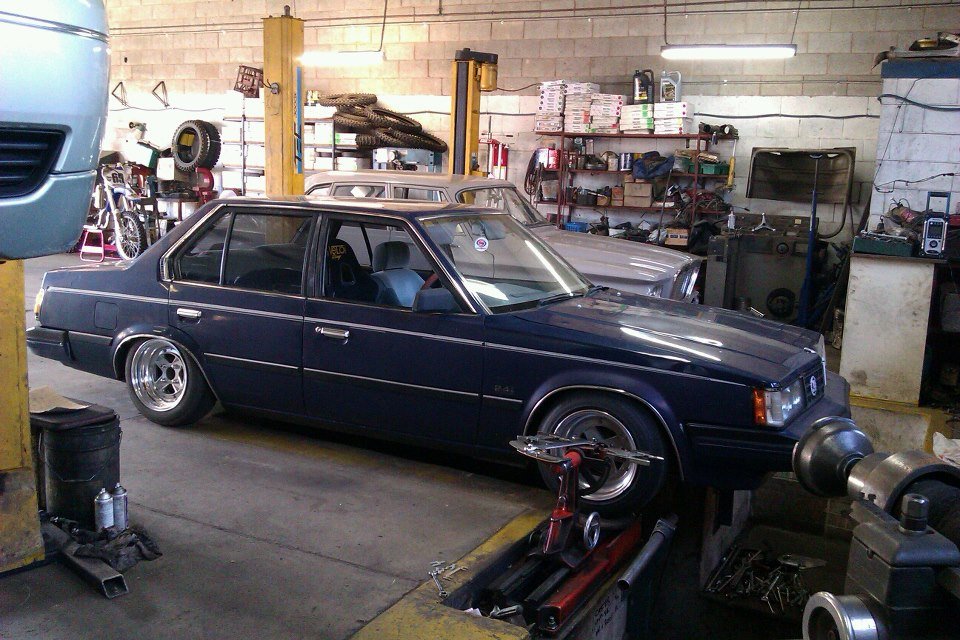

Long time no see. For the very first time I am proud to announce I own a Toyota!
Story goes.... I had an SR20DE Datsun Stanza when I was one my red p's, did some track days in it, drove it daily, heaps of street. best car ive owned, even if it was a heap of shit haha,
So I sold that to buy/build something I could develop abit more as the stanza was pretty limited ( steering box and shit rear end design) so I bought this S3 trx bluebird a mate had for sale, CA18DET, S13 coilovers, cage, hydro, etc etc. worked on it for a year or so and drove it properly 3 times, it was fast and shit but it was a money pit and I am a uni student and I was getting over it.
So I sold it and picked up this beaaaauty off a good dude named Benzo.
86' Avante RT142, IRS with a tired 22re
When I picked it up off Ben it had 86 coilovers, cut falcons, boogers and a locker.
Current specs
Motor/Drivetrain:
Tired 22re
w57
Locked mx73 4.11
Suspension/Steering
Ae86 coilover front struts
Cusco camber tops
7kg YZ sport springs
TRD blue shocks
40mm AJPS RCA's
Lock spacer
Factory power steer
Garage Clear v3 knuckles
86 brakes with QFM? pads
Superpro bushes
210mm AU falcon springs
HSD 16 way adj. shocks
Whiteline 18mm adjustable ma61 swaybar
Interior:
Sparco two spoke wheel
Velo GP90 bucket
Bond roll bars 4 point cage
Wheels:
14"
8 -12
185/60 re001
7.5 -6
175/65 freebies
SSR mk2
I drive this daily and really enjoy it, its a really fun simple car, Might put a beams in it one day but for now im going to try and make the most out of the 22re! Entered at a vicdrift prac day on the 11th of May so come say hi!
