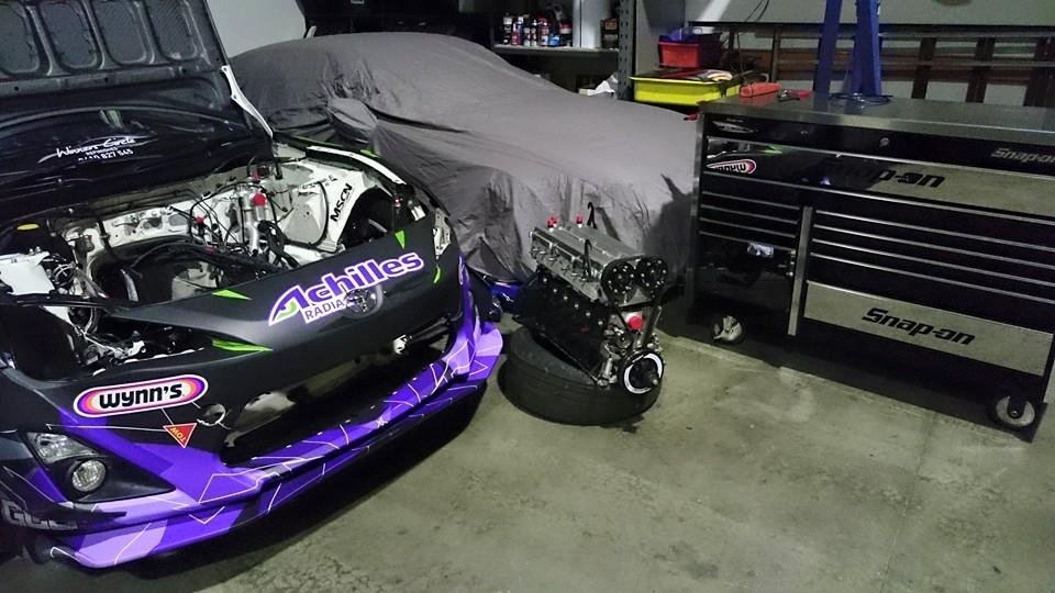

    Bit of old news, but Beau was running with no timing belt covers and it appears a bit of rubber has flicked up and got in between the belt and the gears causing it to jump. Being interference the head will have to come off and valves repaired unfortunately.
    Its a bit of bad luck , but I'm sure the guys from JHH racing have seen this before and will have it back on the track in no time.
    I'm sure Mitch and the boys at Hypertune will design a cover to prevent this from happening again.
