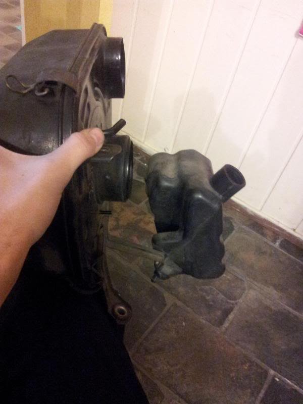

    As the title says, what's this black reservoir type deal on the airbox. It appears to have a vaccuum attachment at bottom and an attachement for something the size of a radiator hose at top.
    What's its function, do I need it, what affect will that have if I delete it etc.

    It's there to cut down intake noise, the snorkel has a hole in it that links up to it.
    Safe to ditch it, I just bypassed it as you loose air flow for no reqson

    Cheers mate, consider it deleted.

    that's a resonator housing, to remove harmonics from certain parts of the engine rev range. As above it's noise only.
