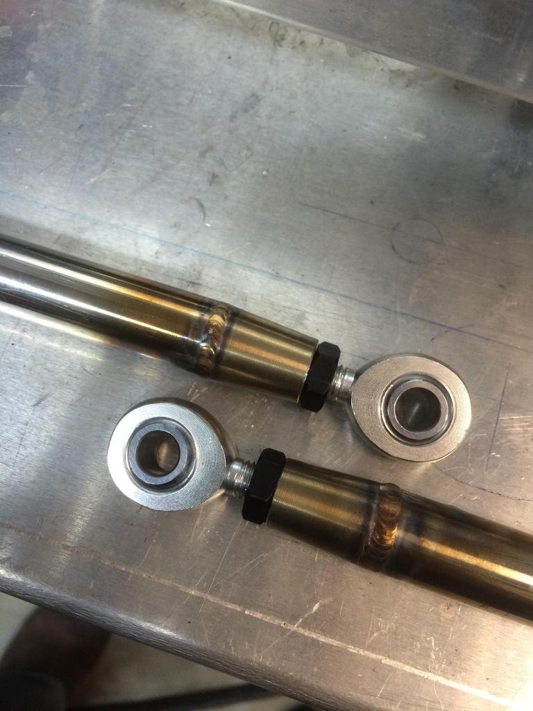

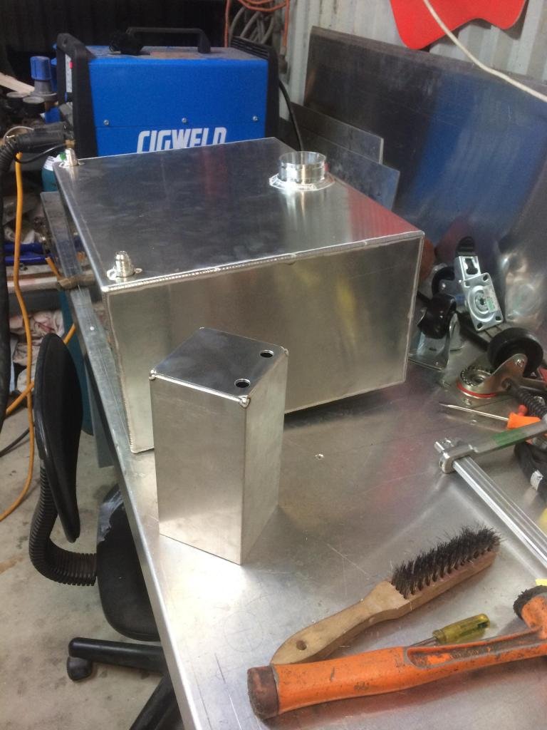

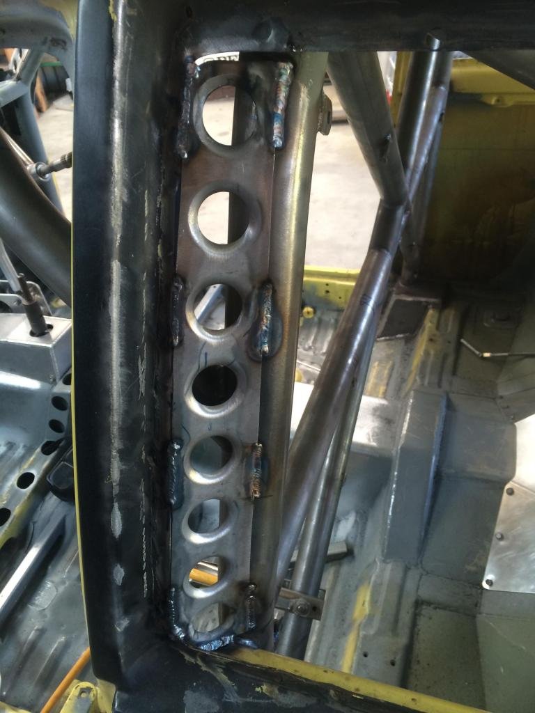

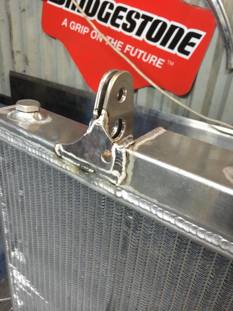

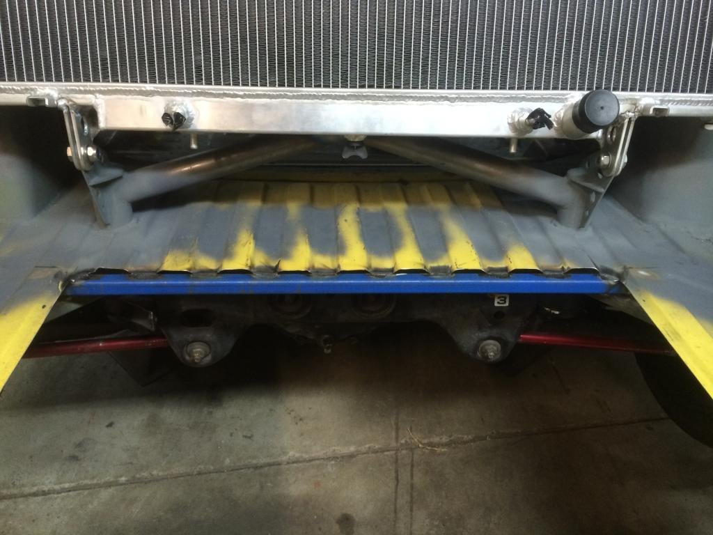

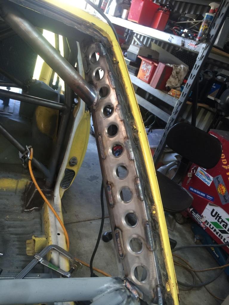

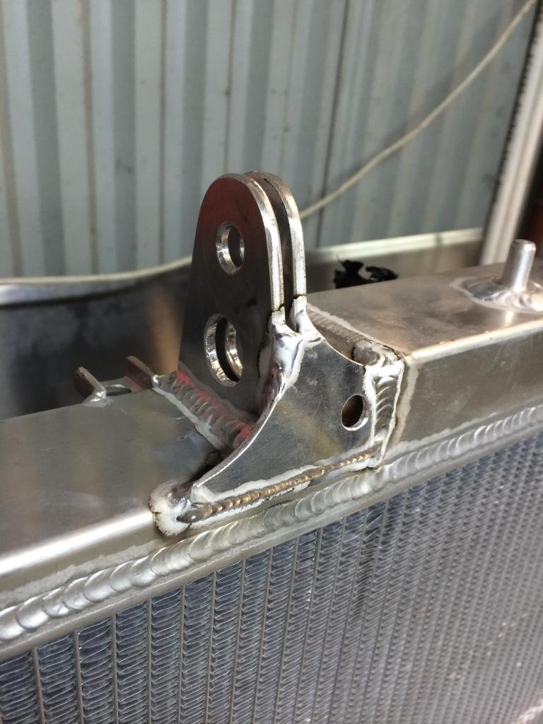

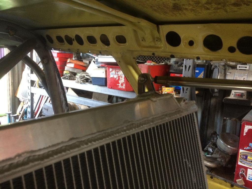

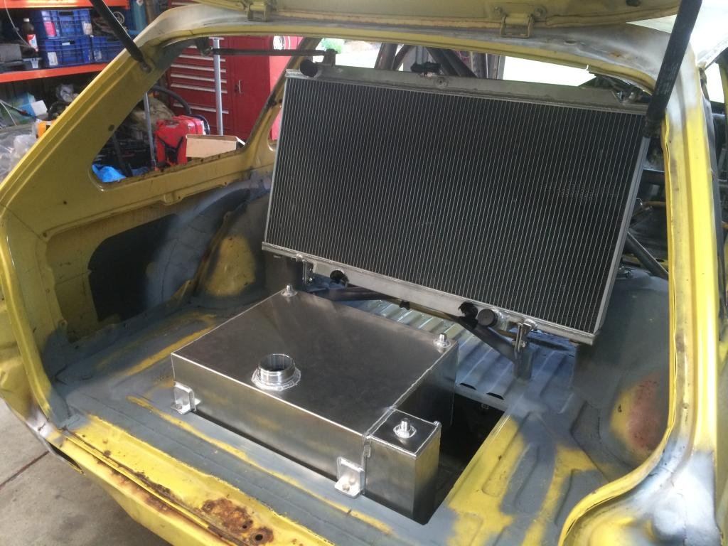

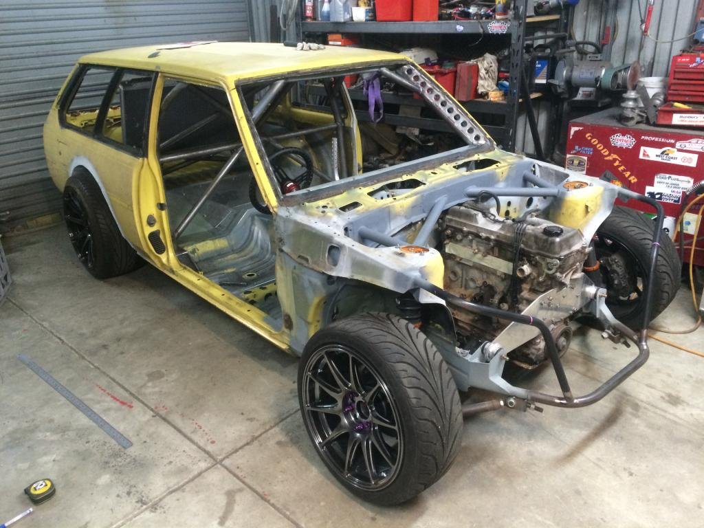

    Okay! So I havent updated in way too long! Here's the first few bits: Cage gussets, mounted the triple core patrol radiator, fabbed and fitted fuel and surge tank.

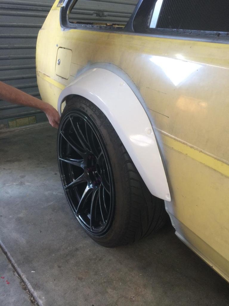

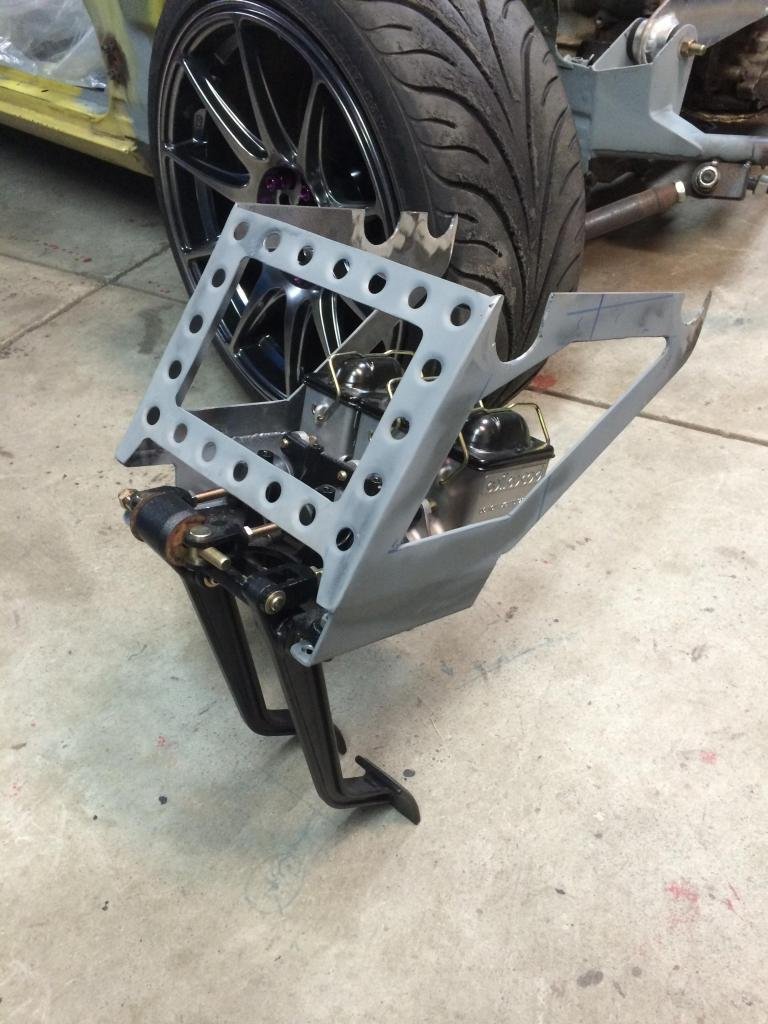

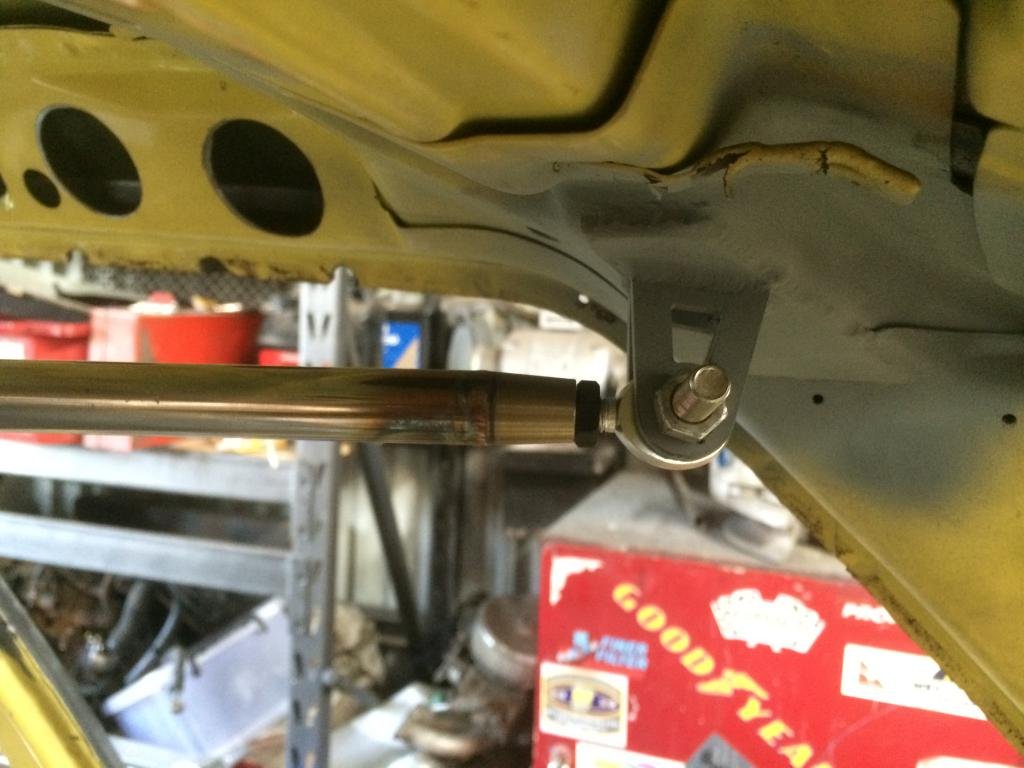

    Added the main part of the tube frame front, finished of the pedal box mount and bought some dmax flares for the rear:

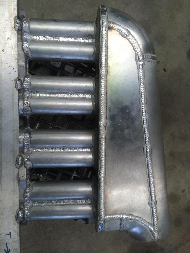

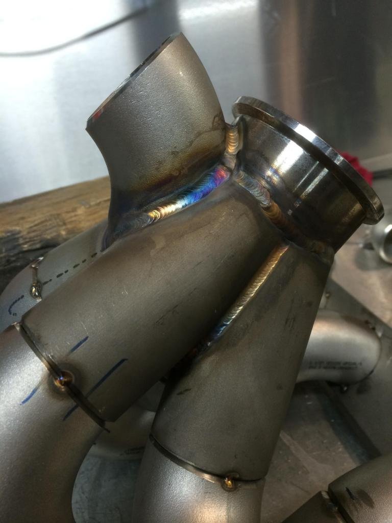

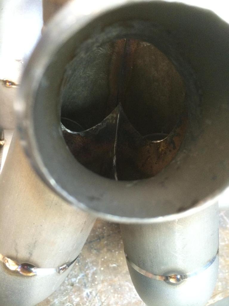

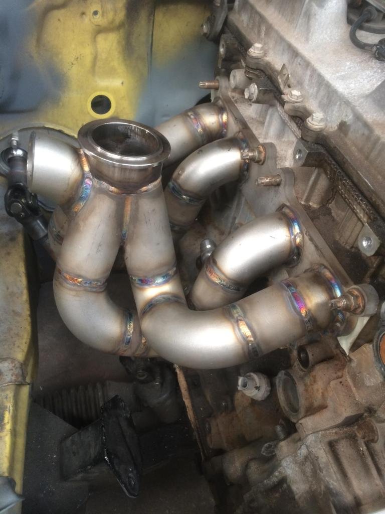

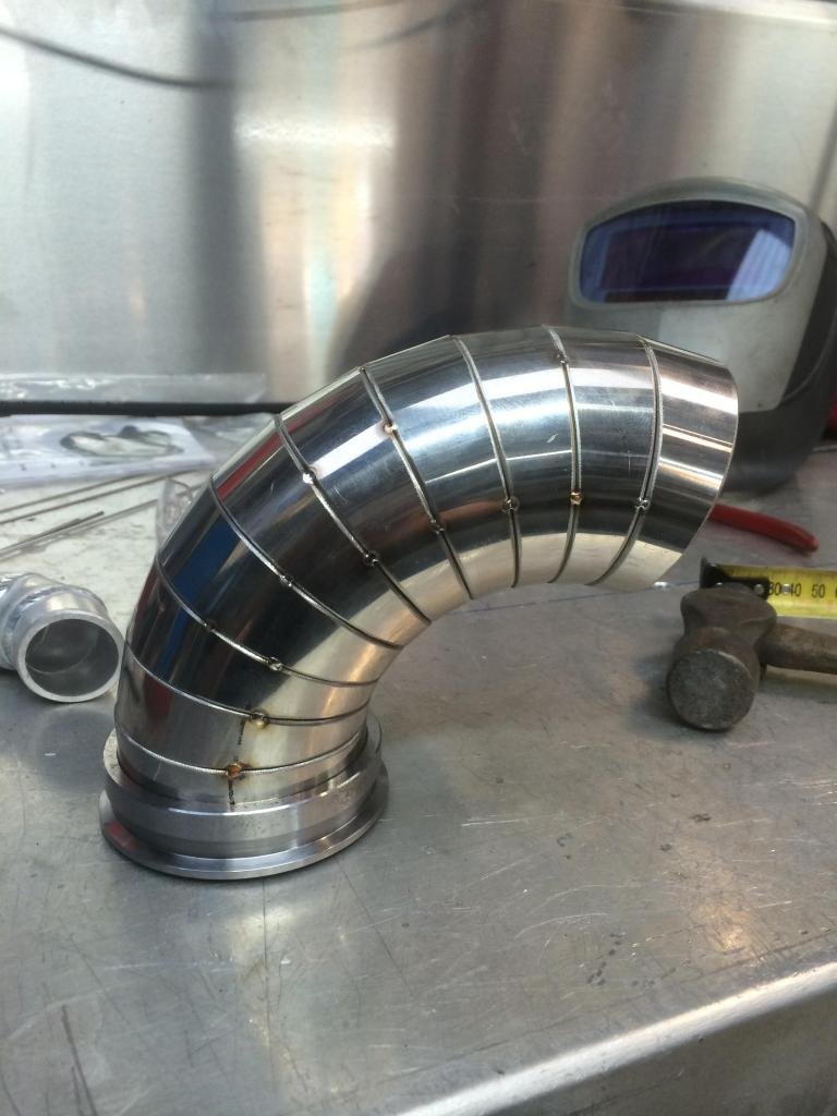

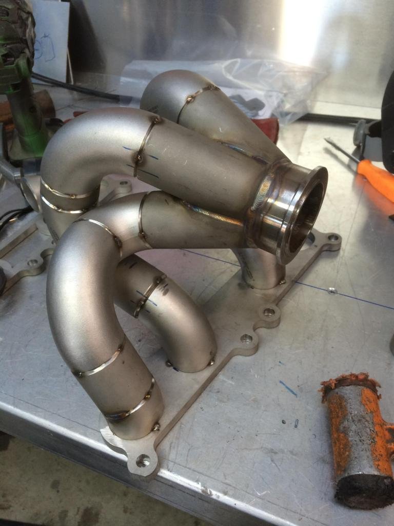

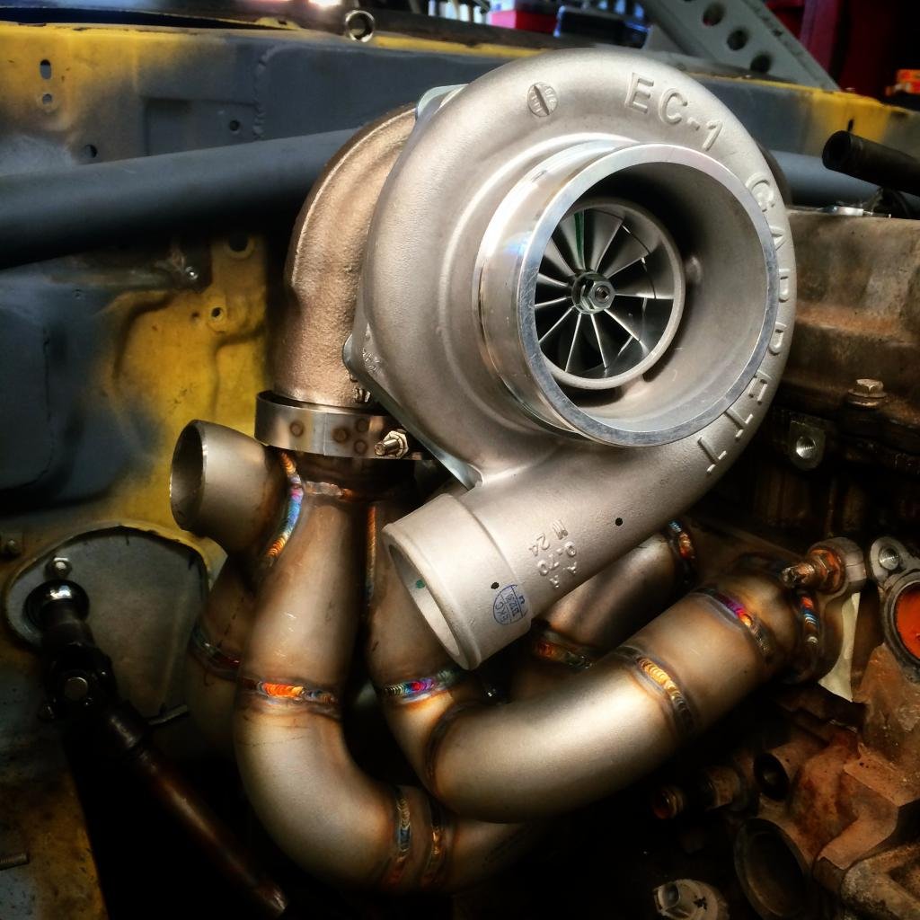

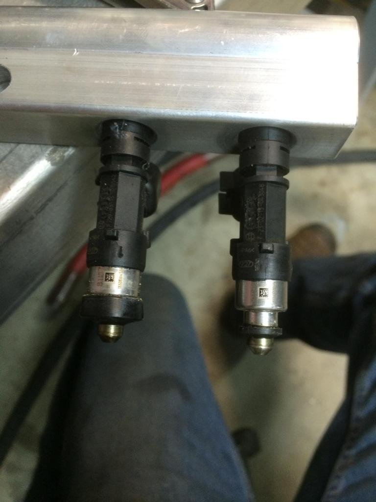

    Then started on the cool shit! Intake and exhaust manifolds! Received my engine internals (no picture yet) and an 8 injector fuel rail so I can run a 1000cc injector into each port. Waiting on the weld in injector bosses, put on the throttle body and thats done. Bought a GTX3582R with V band rear housing and made a stainless steel exhaust manifold to suit:
    Edited Instagram pic, add me: savagefab
    Just started the dump tonight:

    Have you got a link for the flares at all
