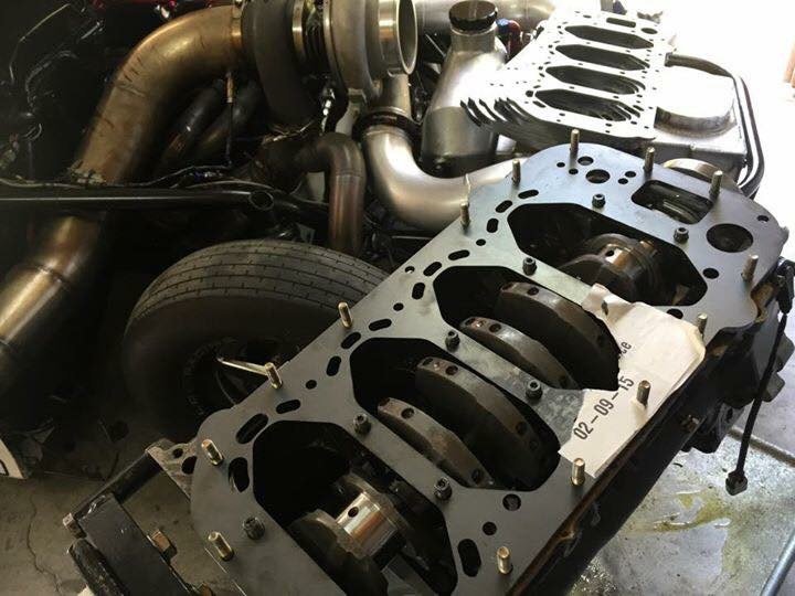

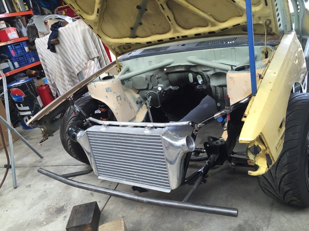

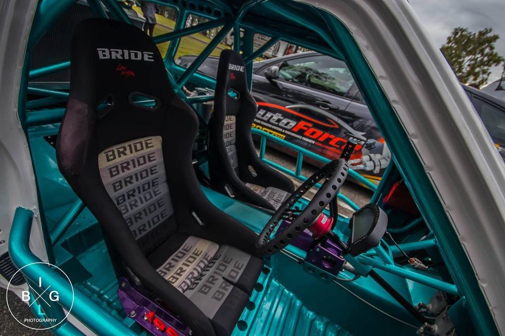

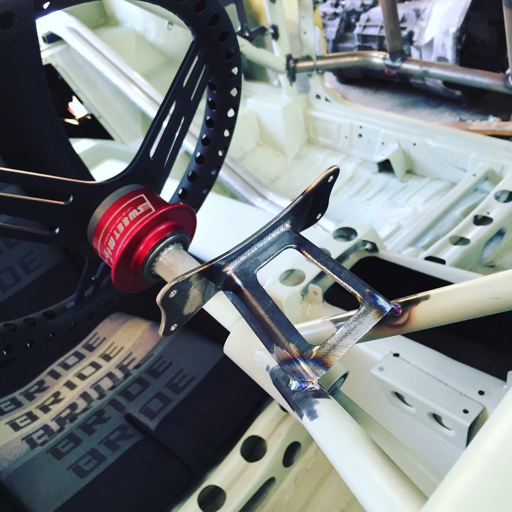

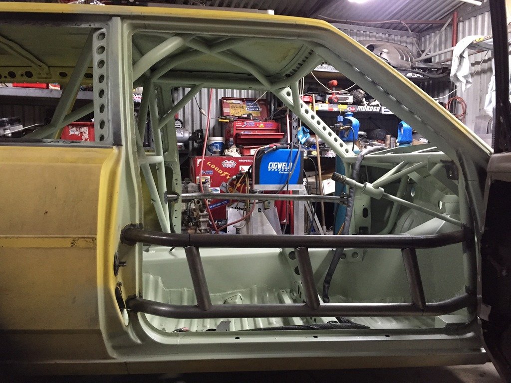

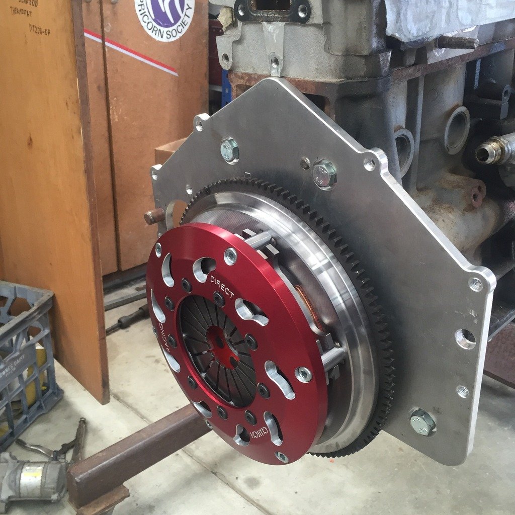

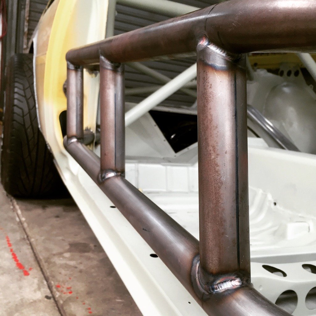

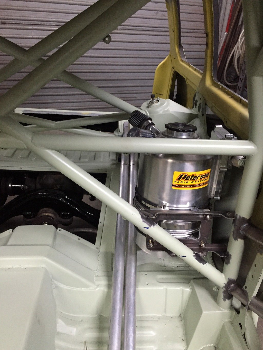

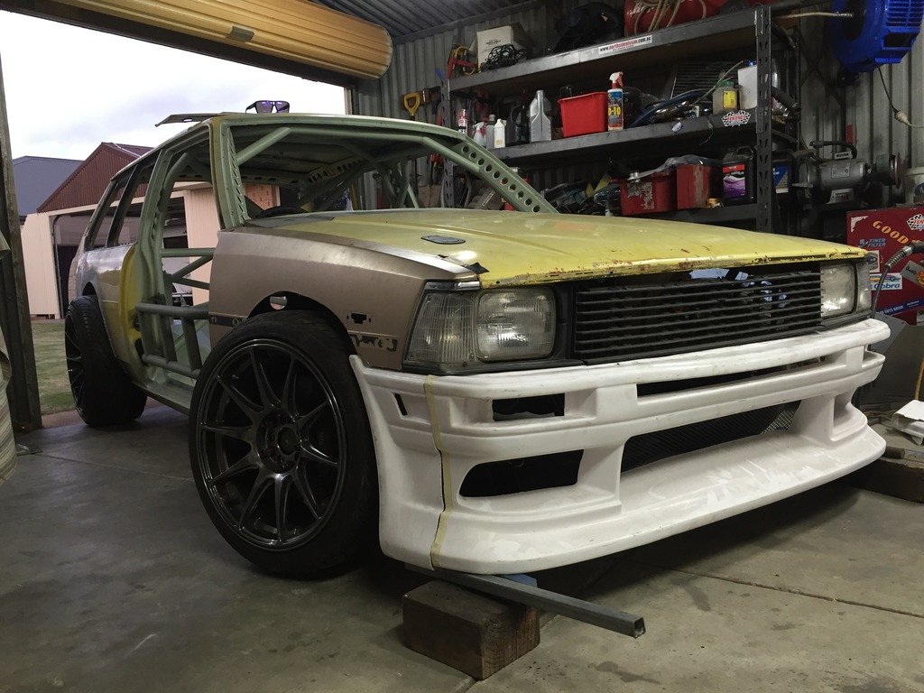

    So I've finished off the cage door bars, mounted the oil tank and dash, bought a crank girdle (same as pictured) and a custom twinplate clutch.

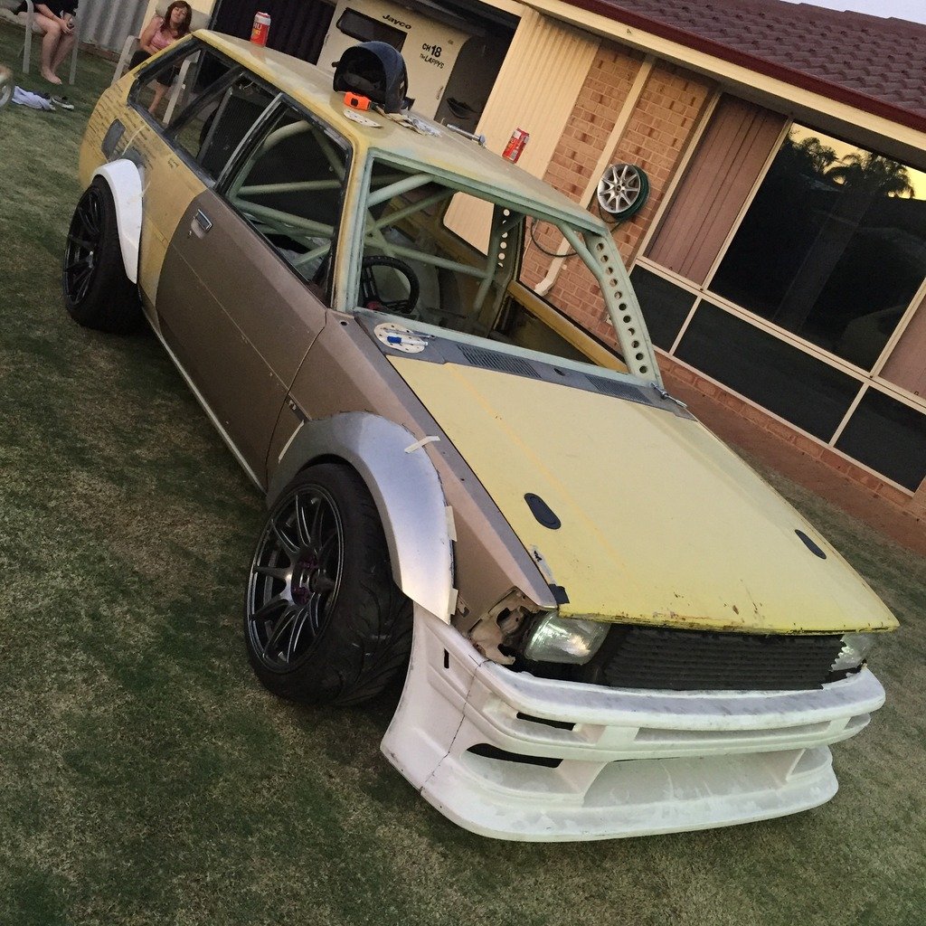

    Now its time to start doing the bodywork...
    This will not be to ANY of your customs, but its my car and I don't care. Keep in mind these are only the early stages of it all and what I plan to do. No h8 plz

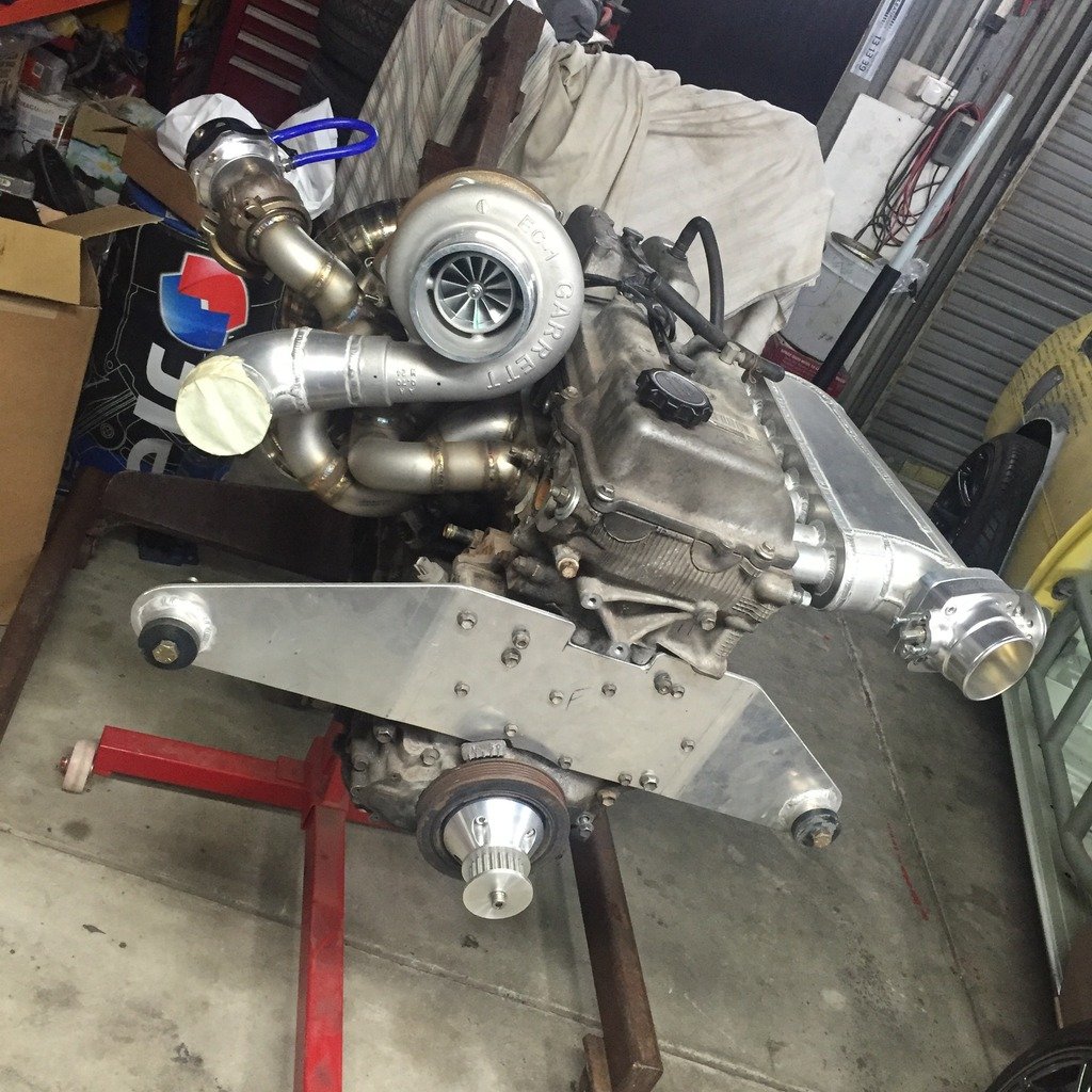

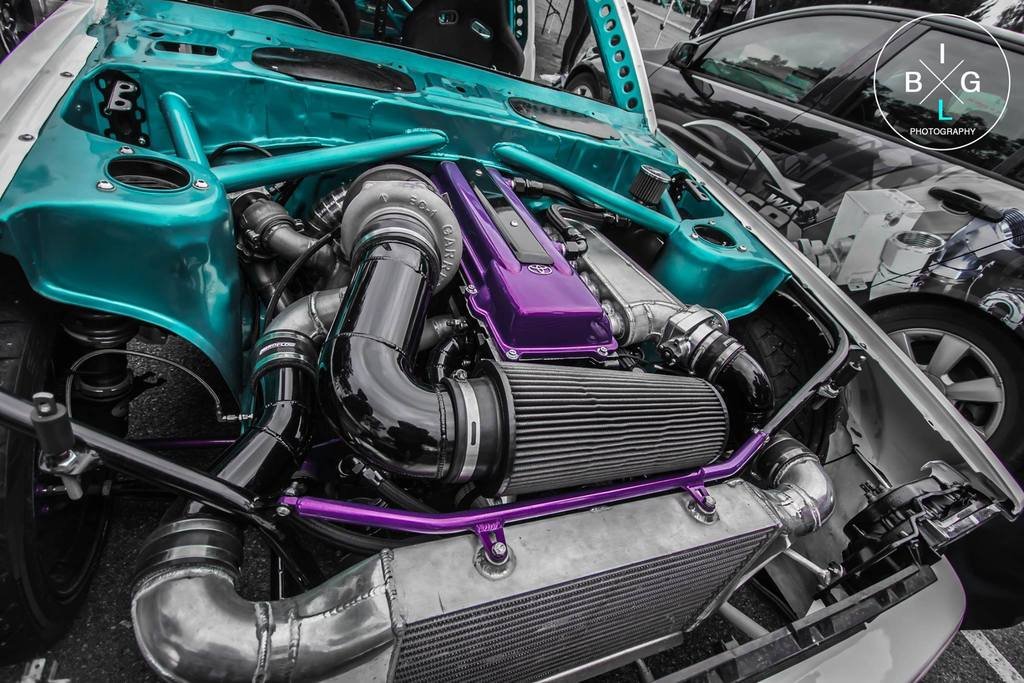

    Now an engine pic to make everyone happy again.

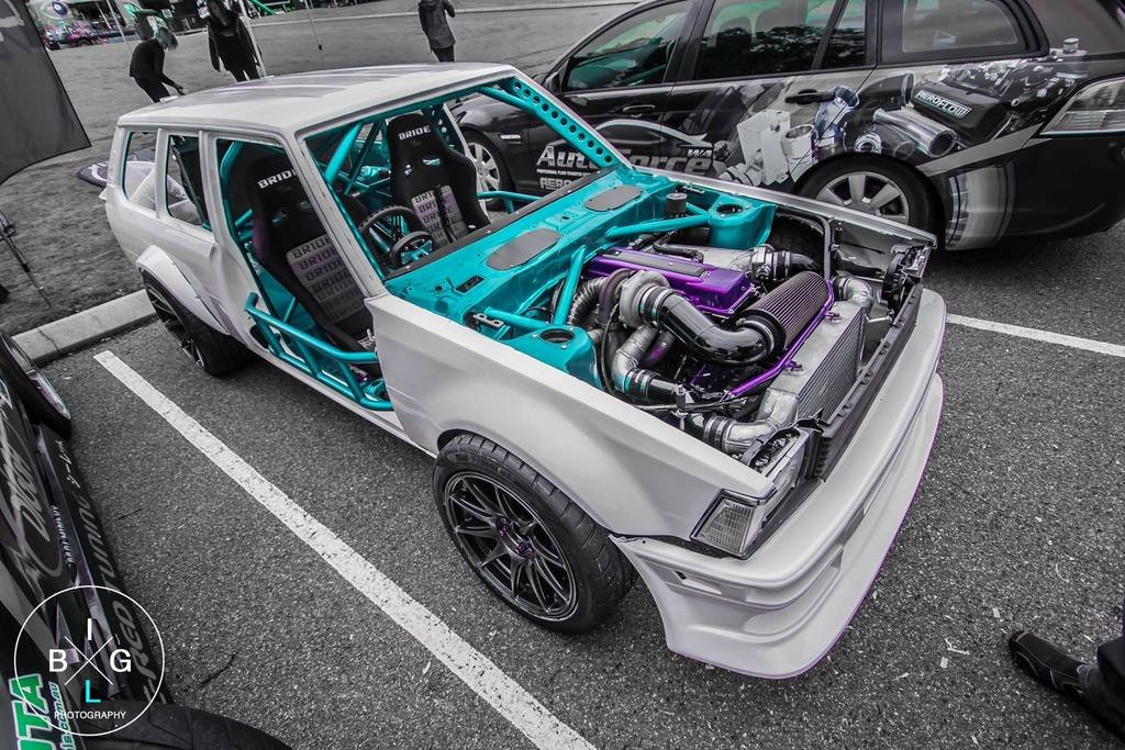

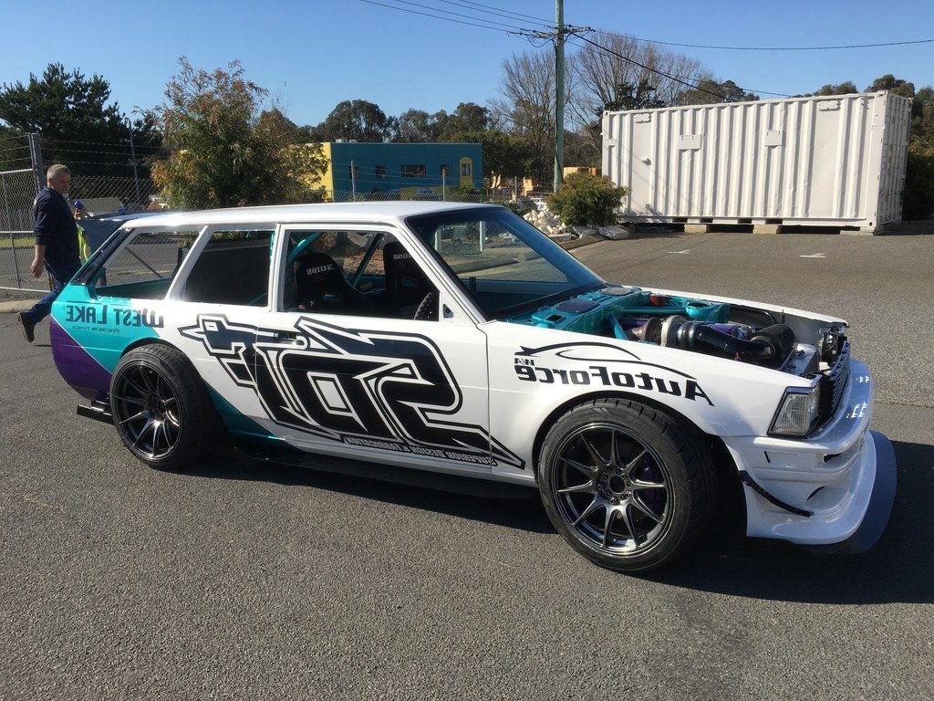

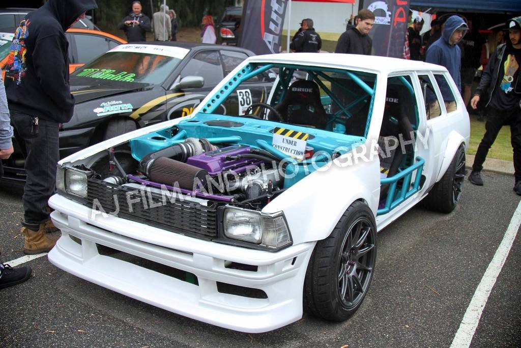

    Yeah so a bit has happened lately and I took the car to a show for one of my sponsors, hopefully this will be completed within the month.

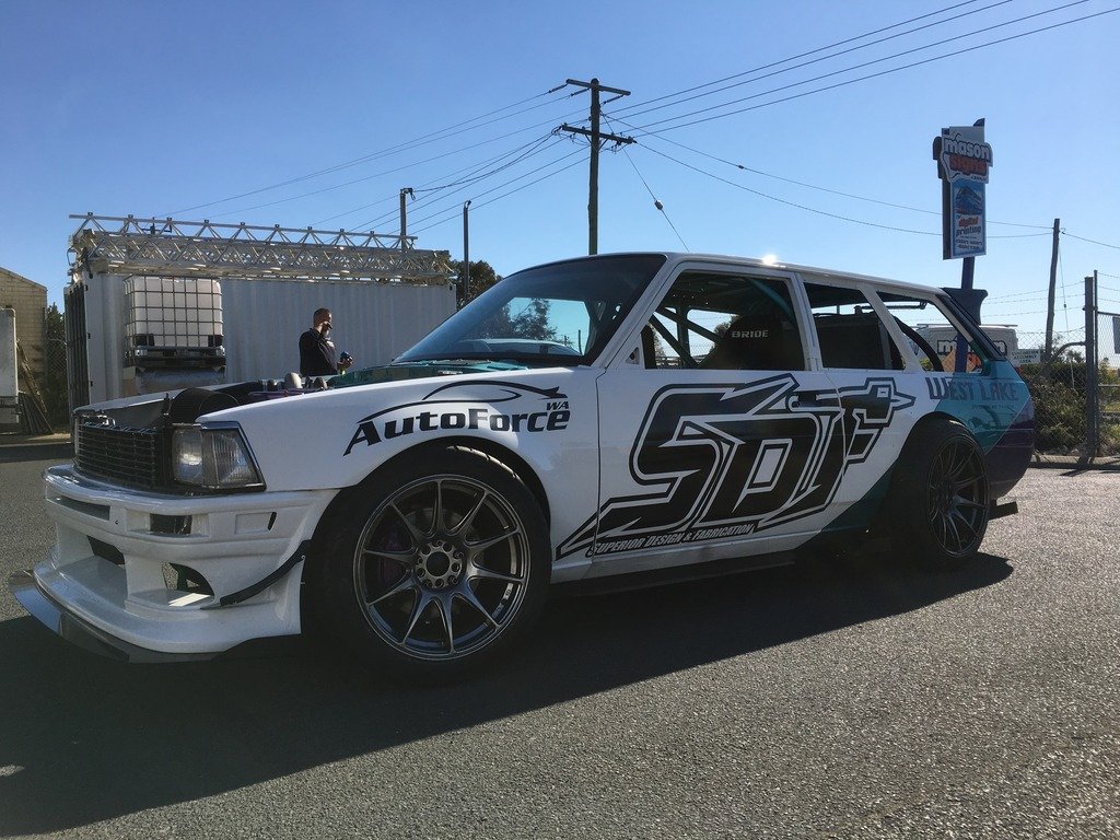

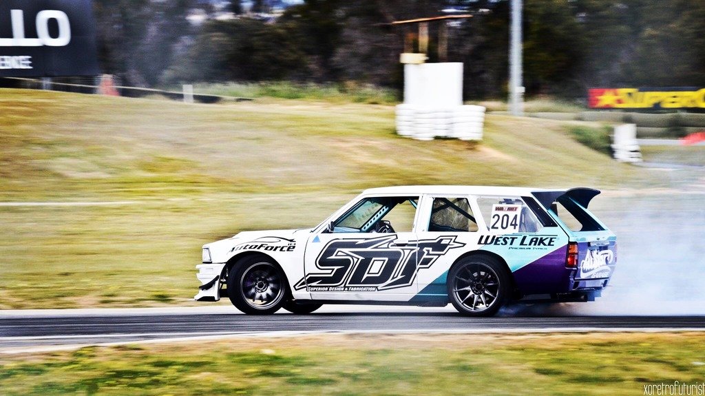

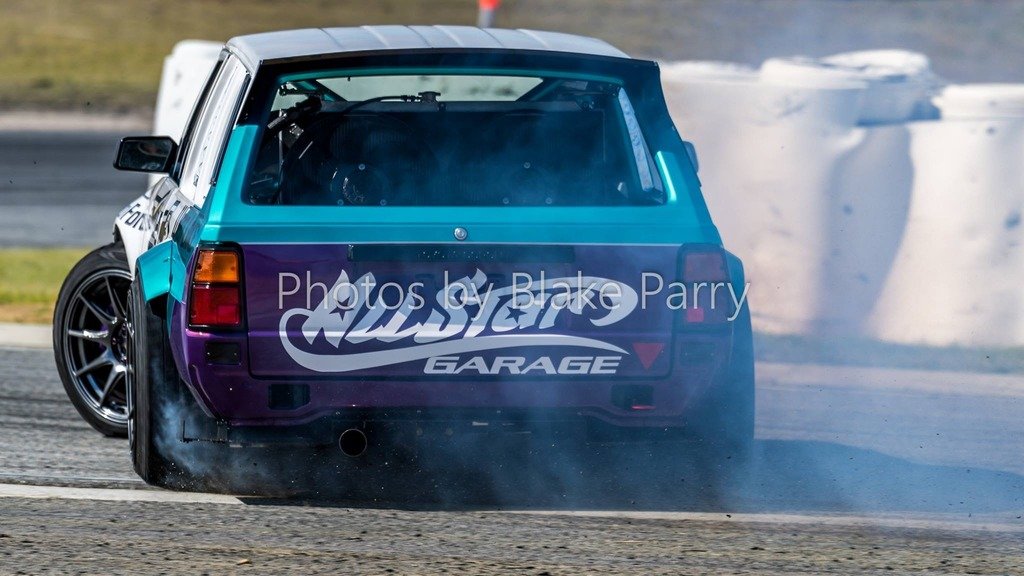

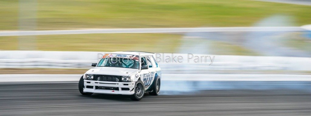

    Got the car finished and signwritten. Finally got to drive it for the first time at barbagallo. The 3RZ made 441hp and 536nm at 20psi, it fell over up top on the dyno and the tuner didnt want to keep pushin it like that, so I have since ordered a new set of kelford cams to help it breathe and reach the 600hp goal im aiming for. It weighs a total od 1085kg's.
    On another note for the JDM yolo gods on here, the panno goes very well with a 265/35/18 on the rear with low pressure
