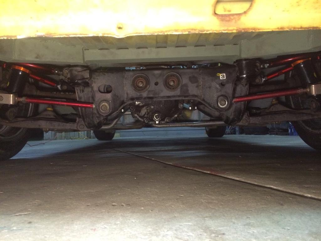

    Rear end is finally done consisting of:
    S15 cradle,LCA's and knuckles
    S13 hubs to get 4 stud
    Adjustable camber, traction and toe arms
    R33 5 bolt R200 lsd yet to be shimmed
    R33 5 bolt axles
    R33 calipers and discs re drilled to 4 stud
    Whiteline adjustable swaybar
    Shockworks custom valved coilovers
    My 3rz to chevy trans adaptor plate should be here next week hopefully
