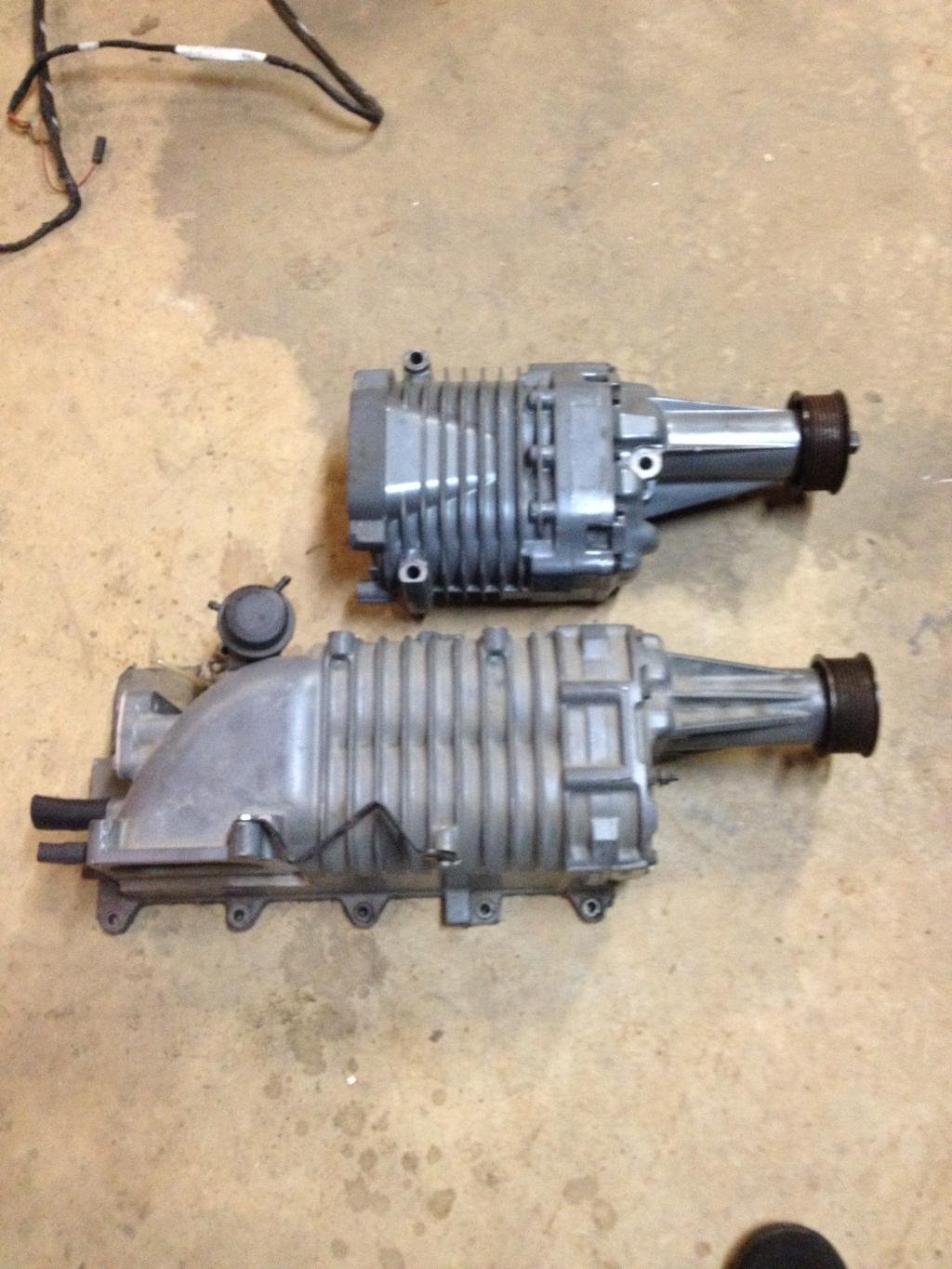

    Motor or wise ill be supercharging the 1uz with an eaton m112 blower, looking to squeeze around 400whp out of it.

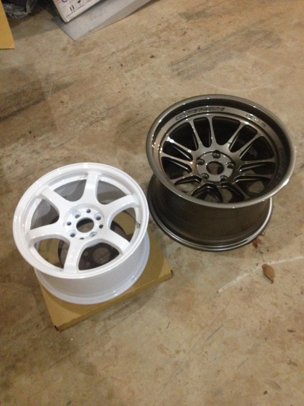

    I plan on running 18x11 wheels with 285/35-18 tires. Huge for an ae86 I know, but bear with me.

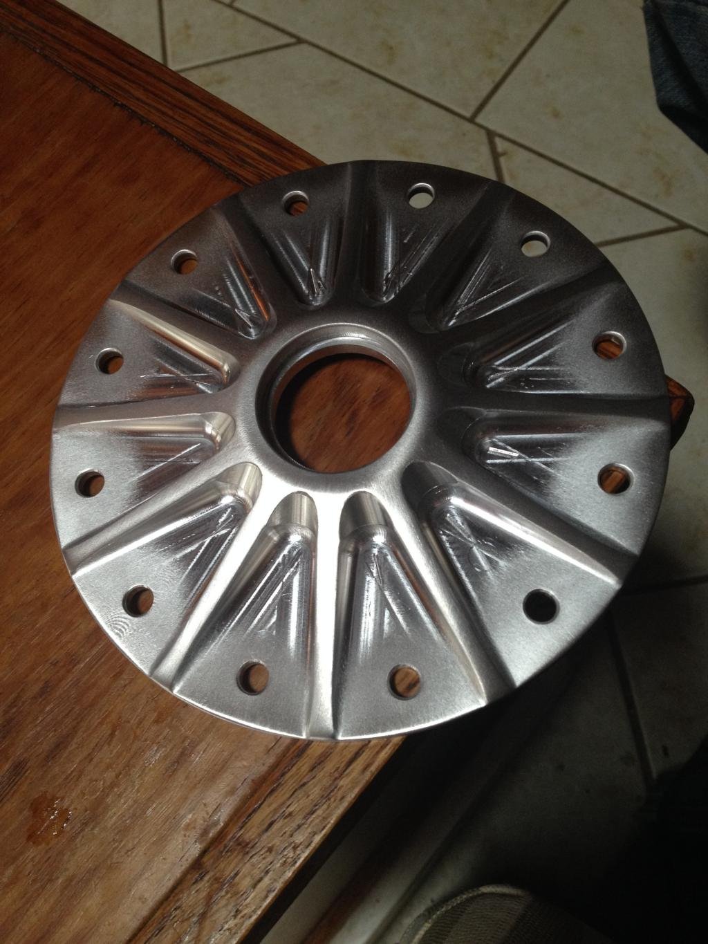

    My my only real progress so far has been the fuel cell mount. I have tons of other projects and I tend to work on multiple things at once.
    Click image for larger version.
    Opinions? Tell me I'm stupid, whatever. Here is where it goes.
    ambitious!
    seems like overkill
    especially in the rim department - smaller diameter and bigger profile will be better
    cars like this usually end up feeling very unbalanced - what sort of tracks will you be racing on?

    I've gone back and forth several times on the wheel tire size issue. I finally decided on the large size for a few reasons despite the unsprung rotating weight penaltie. I'll have to run a DOT tire, which limits my options. 245 width would be my max size with a 15" wheel. With the 18"s I can actually spend less on tires that will last slightly longer due to circumference. Break away characteristics will be less progressive and harder to manage at the limit, but a longer wheelbase and wider track width will help with that. Wheel size would also limit my effective brake size.

    Motor- I'd love a naturally asperated high revving v8. The ls7 is my dream motor. Unfortunatly that's way out of my budget. I'm trying to keep this entire car under 10k dollars. The 1uz is a good engine that could be swapped out at a later date. If the 1uz with a blower fits, an Ls motor will easily fit. I'll be building an intake manifold with air to water intercooler for the m112. I'm hoping to run between 12-14 lbs of boost on the stock motor, while keeping AIT as low as possible of course.

    m112 blower, bottom, I'll be cutting up and highly modifying.
    Wheels, (big ones, small ones are for my golf)
    and I started on my fuel cell filler neck.
