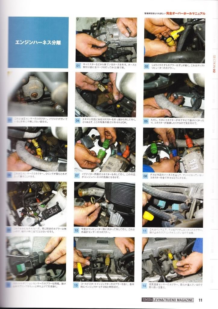

    Here is a view of all the sensors on a 4age engine. This will be VERY USEFUL when trying to diagnose a fault with your car.
    If some one says "check the coolant temp sensor" now you will have an idea of what it looks like, the connector and where its located
